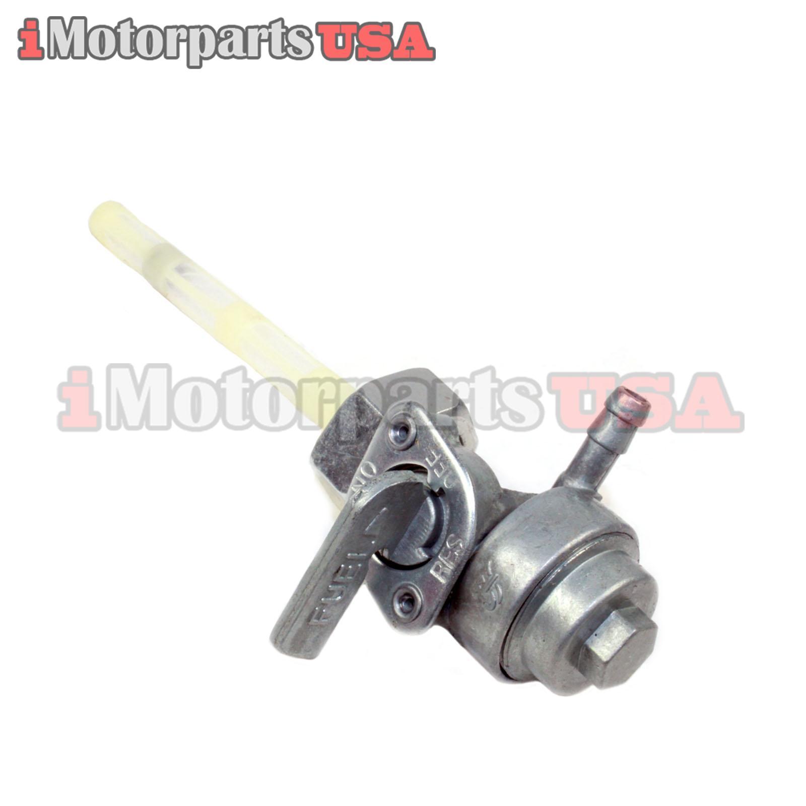

Hey Everyone,
Im looking for that rare petcock that was only around for a few years off a honda cb550.  The nut size is 19 or 20 mm
http://www.hondaofriverhead.com/fiche_section_detail.asp
Does anyone have another source besides the $100 one on ebay yet?
Any work arounds to get something else to work other than oem on the tank?
Or does one know the thread size on the tank?
One of my CB500's came with this CB550 tank along with comstar wheels and its now the only good tank I have left to use for a project.

 Unfortunately, you're stuck with the ~$100 one. I believe there's a CB750 petcock that has the right size bung but is only single outlet. By the time you get a Tee, extra fuel line, etc., you're only saving about ten bucks, though.

 None of those will work except for maybe the last one. I found a CB750 petcock that was the right thread/mount but, as stated earlier, it's single outlet.
 Buy that one for $70, add another $8-10 for a fuel Tee, and you're within $10-15 of getting the correct, HONDA petcock for your bike.
 I researched this forever when I had this problem. Unless things have changed in the last year or two, you have no other options.

If I'm not mistaken, this cheap one on ebay fits. I have a CB750F tank that uses the same size as some CB550 tanks. My only issues with this one is 1) the outlet is to the side, while Honda had the outlet to the rear 2) the outlet is smaller than a stock CB750, but with a short length of smaller hose to the larger diameter T I made it work. I just don't think it flows as much as the motor might want if I was to run WOT for more than a few moments.
There is a 16mm threaded one and a 18mm thread. Not sure which one I used, and they don't seem to be able to say for certain either.
http://www.ebay.com/itm/291123136587?_trksid=p2060778.m1438.l2649&ssPageName=STRK%3AMEBIDX%3AIT

Here's what I'm looking at.
Re: That pesky/elusive 550 petcock
« Reply #23 on: March 24, 2017, 08:52:16 AM »
Correct-a-mundo.
ALSO -- Buy cheap Chinese knock-offs at your peril.
Pay for the more expensive OEM part and then you won't have to worry about it.
Offline Scott S
  • Posts: 8,251
« Reply #24 on: March 24, 2017, 09:09:24 AM »
 Genuine Honda one year only petcock is about your only choice. Unless that black tank is a '77-78 tank. Last I checked, they were about $100.
