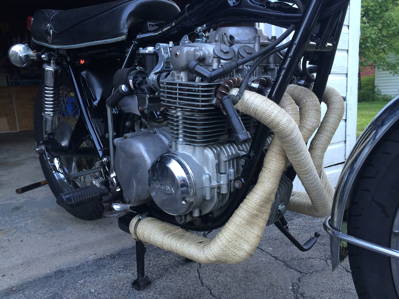

And a single 4 pack of 12mm 14" ties for the end of the collector and the bigginning and end of my muffler pipe (I'll get a pick in a little bit so you can see what I mean, my muffler is welded to a pipe that then gets clamped to the collector)

Obviously not pushed all the way on, not clamped, I still have the chrome cover for the collectors (Looks pretty good on there too, just a little pitted)
Still need to figure out a little thing to hold it to the center stand stop, or fab a new one all together (would look cleaner)

Thanks but I want the wrap to look continuous from the top to the beginning of the muffler, but I need it to come off so I'll have to make two separate wraps. You'll see what I mean on the pic up a few posts with the pipe off the collector
