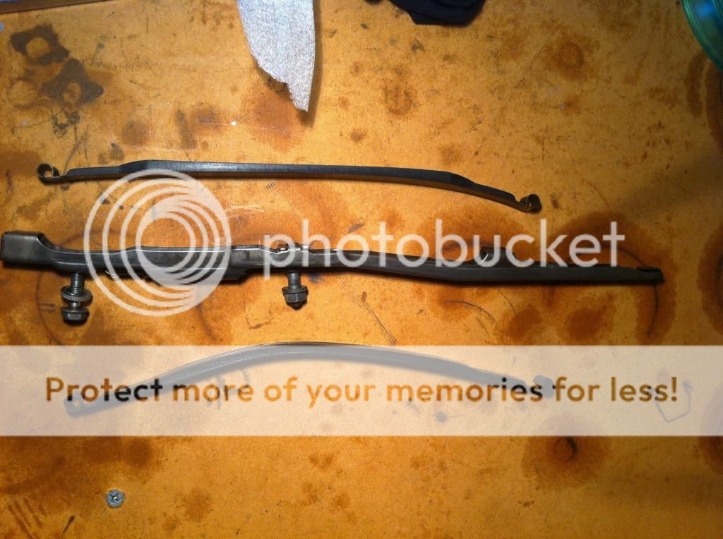

Anybody able to tell me if the CB550 cam chain tensioner blade has a specific orientation in fitting into the cam chain tensioner assembly? The shape isn't symmetrical, it has differing bends either end.
I forgot to check the old one before removing, there are no marks indicating up or anything similar. As you can see, left end of the tensioner blade is straighter, and the right end has a much more significant curve. New tensioner is the top one.
Or does this have no effect?

just the way its come of the line,doesent matter,youll be bending it to use it.

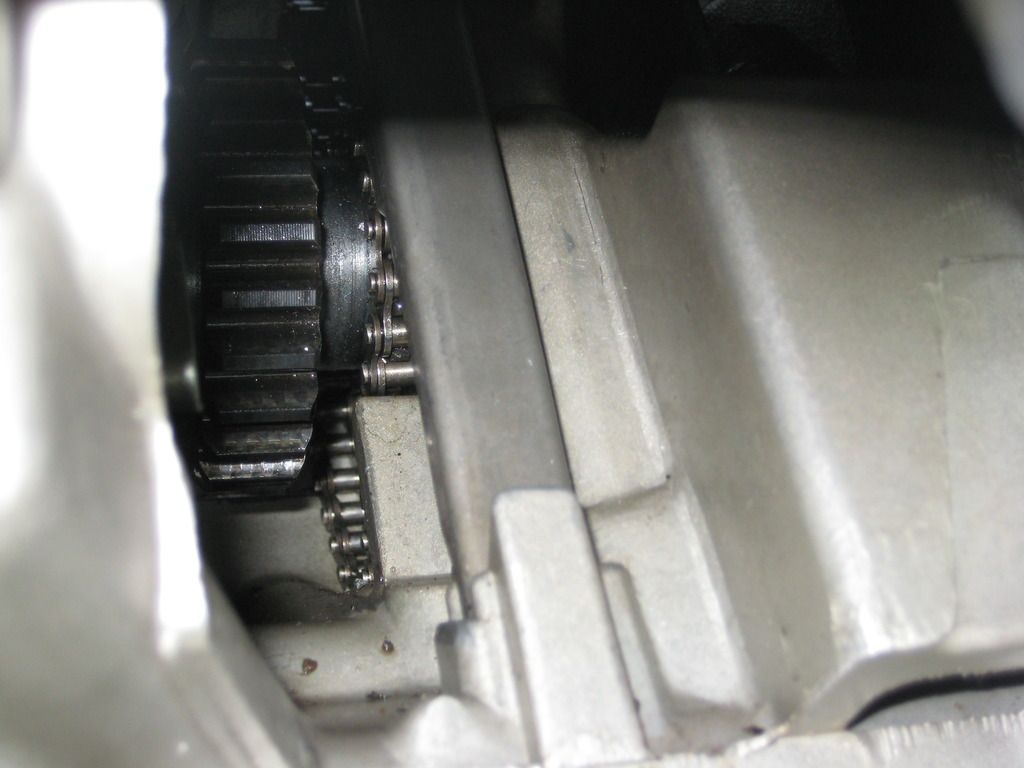

its a wrangle with the barrel on,if the barrel is off I have it inserted first then lower the lot down,drop the pan when you fit the new tensioner!make sure its lower end goes into the little slot it lives in,its so easy to miscue it and almost impossible to spot from above!heres one I found miscued.
Nice picture Dave.  Do you have picture of tensioner properly seated?

I've noticed a lack of Dave's wisdom & banter around the forums of recent, hopefully he'll be back from the beer run soon.
I think I've got a picture of that somewhere Gold, I'll see if I can find it - although I don't think theres much to see from below when it's seated?

In Dave's absence...
Nice and clean pic bwaller.  Exactly what I fear to see.
