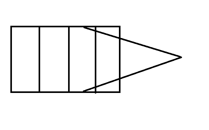

anyone here built a trailer?id like say a 7x4 box with front and rear hatch,not real deep,using shackle leafs not those stupid rattley squeaking slider springs,how does a basic frame sound made from two 50x50x2.5 side rails with five 50x25x2.5 cross pieces,using an apex sort of draw bar starting at the front spring hanger and 75x50x3,that should all be pretty sturdy?some of the new trailers ive seen for sale look like real crap!pissy 35mm rhs or shs tube and only welded on two sides on the cross pieces,some only had three cross pieces of angle iron,if I can get my welding up to par I could make a better one at home,ive priced the frame steel cut to length at 150 bucks,i already have wheels and axle,guards can be bought for 40 bucks and springs etc.

Dave, I've made a few trailers over the years, every one has had this basic design.  If it is a 6x4 I only put in 4 cross pieces instead of 5 for a 7 or 8x5.  I find the piece of box running from the apex of the drawbar back to the centre of trailer unnecessary and only adds excess weight, which you want to keep down on the 750kg trailer.  My current trailer is made of 1 3/4x 3/4 or something like that, you don't need overly wide box steel if you use a steel floor.  You weld the floor to the frame and the sheeting becomes part of the strength.  My drawbar is 3x2, and plenty strong enough and relatively light.  If you want somewhere to put your spare, weld a brace crossways on your drawbar and attach it there.  If you need trailer parts these fellas used to be bloody sharp on their prices and right on your doorstep. ;D

thanks Andrew and prokop, ive saved that link ill check them out later,i was going to mount the axle slightly behind the centre line of the square frame and no centre bar through the drawbar.

If it's a concern at all to you, Dave, the farther back you can install the axle the better. It increases the wheelbase and slows the jack-knife of the trailer when backing up. Trailer is already somewhat short, and will want to kink very quickly. Not carrying much weight, so axles rearward is not a genuine load concern.
Thought I'd point that out if you hadn't considered it. I've pulled lots of single, dual and triple axle trailers around. Singles are always the worst for controlling going backwards.
The other option to a good backing trailer Cal is to have a longer draw bar at the front of the trailer, it has the same effect of making it easier to back up without adding extra weight to the front, trailers with the wheels at the back are usually heavy to lift up when coupling to the vehicle, especially if loaded uncoupled, longer draw bar {front rails that mount to the vehicle} don't add anywhere near as much weight to either the front of the trailer or the rear of the tow vehicle...... ;)

Don't mount the axle or guards until the very end.  Sit the completed box and drawbar on the axle, move the axle forward and aft until you are happy with the down weight on the tongue, I like about 20-40kg down with an empty trailer, depending on the size.  Mark where you want the axel once you are happy, turn it all upside down and attach the springs.  Then turn it right side up and attach the guards.  Remember make sure your frame is square and your axel is square to the frame and the drawbar is also square and centred.  I never use a square to do so, I've always found the best way to do so is measure the diagonals.  If they measure the same from side to side it is square.  ;D

thanks Andrew,i was going to mount the axle rear of the frame centre line by about 75-100mm,ill do your balancing act first though to see how it feels that way,i have a big rafter square ill use to tack up but had intentions of diagonaly measuring for final welds,thanks mate,that link is great,i rang them for a question and they are helpful there aswell,the parts I need to buy from them comes to around 110 bucks,the frame and draw bar steel about 150 bucks,working out pretty cheap so far when a 6x4 new from somewhere is a bloody $1000 and looks light duty.
