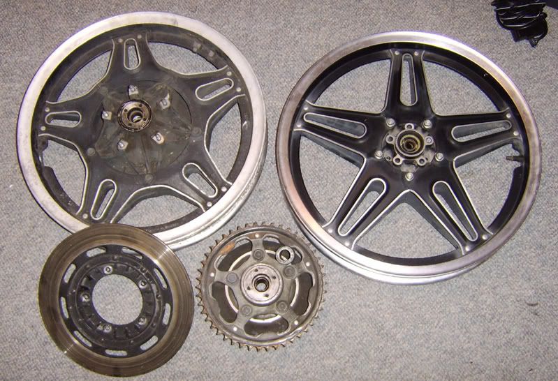

lol, want these?
where do you live---- shipping is going to suck...
lets continue this via PM...

What did they come off of?   Is that rotor for the rear?
                        Terry
Offline crazypj
  • I'm brill, me

« Reply #24 on: October 04, 2006, 11:56:03 PM »
european models got alloy ' reverse spoke' comstars around 1980. They lookm like CB750/900 dohc or maybe the custom 650? What size is the rear?
The brake rotor is a late model, 84 ish
PJ

« Reply #25 on: October 05, 2006, 04:07:58 AM »
Well that rotor looks like it bolts on to the rear.  Its not a 650 front rotor.  No 650 came with a rear disk.  Front looks like mine.
If you look at the front see the holes for the disk are "between" the rivits.  On a single disk comstar the holes are right next to the rivits.
                  Terry
                        Terry
the rear is from an 82-83 CB900F, and the front is from an '81 750F... the rotor looks different because its companion caliper is a dual-piston...

« Reply #27 on: October 05, 2006, 04:32:59 AM »
I undersdand the dual pistons after 82 but look at how it mounts.   Looks like it bolts to the rear not the front.
                    Terry

« Reply #28 on: October 05, 2006, 04:58:19 AM »
                     Are you sure about the rotor? The larger hole and wider bolt pattern does make it look
          like the rear rotor. You might have put it down without realizing it.
                                                                     Later on, Bill
                    Terry
yes, the rotor is off of the rear wheel... not sure how so much confusion came of this... lol

« Reply #32 on: October 05, 2006, 04:25:49 PM »
I'm always confused.   But I did know that wasnt right for a 650.
