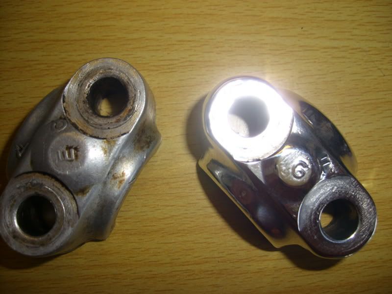

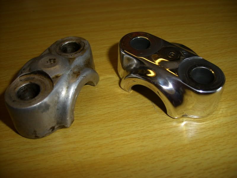

I've done both the sandpaper and small buffing wheels in my drill press and I think the wheel is the way to go.
...an example of before and after with the wheel:   **Click for biggin'
Polished metal is just soo nice to look at. Good job.

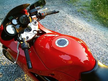

perhaps not, but it makes those hours pass by easier... the thing that REALLY sucks about typical honda aluminum is that it is clearcoated or painted black... so not only do you have to subject yourself to the actual polishing, you have to strip (or sand!) the coating... if only......................
the last major polishing job i did (several parts on a '93 katana), i wet sanded until blood was literally seeping through my skin (from countless micro-abrasions)... pretty freaky, but i ended up with stuff looking like this bar clamp:
you cant really tell in the pic, but the aluminum has a mirror finish, and if i may say so, was quite stunning (and a little distracting when riding at high noon in the summertime  ::) )... OEM was painted nearly flat gray, lol...
