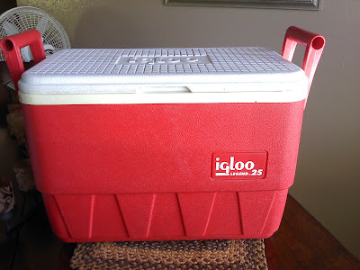

I have shipped smaller motors in a cooler before.  Built a simple block to keep it off the bottom and to keep it from sliding around inside the cooler.

a plastic cooler? they must sure be strong and protective enough

« Reply #7 on: October 24, 2014, 07:23:13 AM »
Yep like an Igloo cooler.

« Reply #8 on: October 24, 2014, 07:32:40 AM »
How do you close the lid to keep it from popping open in transit Harsh ?

You could use stretchtite, people do it for luggage at airports.

« Reply #10 on: October 24, 2014, 10:45:06 AM »
Packing tape.  I like the stuff with the string in it.
