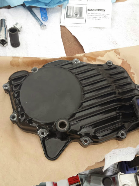

I started to take my engine out of the frame.  I have big plans for the engine!  My first disappointment was splitting the engine case and finding this.
The previous owner saw that the engine case was cracked and used JB weld to hold it together.  Apparently it worked pretty well.  The rest of the engine internals looked great and it was well oiled.
I ended up buying a new case on ebay.  I cleaned it and painted it already.  I sent the crank, transmission, and other parts off to CycleX to have them reworked.  I'm waiting on them to send it back so I can start reassembling the lower case.

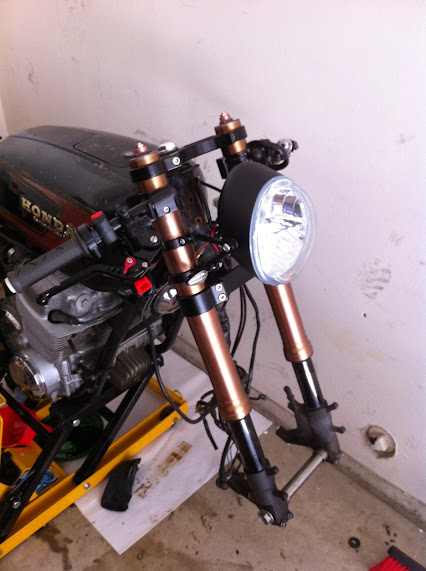

I got rid of the original triple trees that I had bought and replaced them with a set from Cognito Moto.  I think it looks a lot better.  Plus, it got ride of that horrible gap that I was talking about earlier.
I bought these forks on ebay.  After I did the mock up and rested the full weight of the bike on the front end, the forks leaked bad.  I had to send them off to get them rebuilt.  At least I know know that they will be solid.
I changed my mind about the V-Rod headlight and decided to go with a more traditional round headlight.

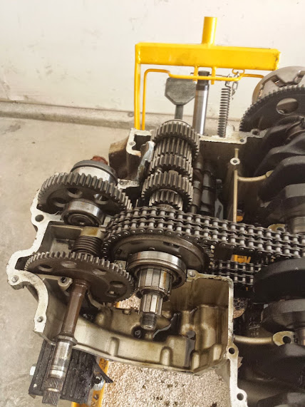

I received my crank from Cycle X.  I got the Pork Chop version and it is gorgeous.  I received a bunch of other goodies like my lighted and balanced alternator, super gasket kit, manual primary chain adjuster, race cut transmission, Cycle X heavy duty primary chain, cam chain, Cycle X heavy duty case studs, etc.....
Here are my Carrillo Rods and they are pretty!
Transmission and Cycle X primary chain adjuster installed

Now comes all the fun.  I bought Hondaman's book, I have the shop manual, and I watched assembly videos online.  I felt pretty good putting the crankcase back together.  This bastard was a pain in the a$$!  Nothing went together like it did in the videos.  But I managed to get everything installed and I used Hondabond 4 to seal the case.
I'm glad that this part is over.  The next headache was turning the engine over and reinstalling the oil drain plug.  This is where I found out that it was stripped.  I can't believe that I had missed this.  I unscrewed it and it look fine when I was breaking the engine down.  So I sent the oil pan and a bunch of other parts off to get powdercoated.  What to do now?  So I ordered a Time-Sert Kit online.  I did some research and this was the best option that I found.  The kit looked pretty good and was very simple to retap the hole and install the kit's insert.
The kit was kind of expensive, but it worked like a charm and is better than new!

And now the fun really begins.  After fixing and reinstalling the oil pan, I decided to work on the gear shifting mechanism.  Everything went together just fine.  That's when I noticed that the main bolt that holds most of the shifter parts was bent.  I don't know if you can tell from the picture, but it is definitely bent.  I decided that it wasn't worth the hassle and ordered another one off of ebay.
With the gear shift section on hold, I decided to get my neighbor to help me drop the crankcase into the frame.  It went in pretty easy and the swingarm spools that I installed worked like a charm.
I received my gear shift parts in the mail and decided to work on that piece.  I put my wrench on the bolt and it snapped off like a toothpick.  WTF!!!  I barely even applied pressure to it and now I have to deal with this!
Now this part is on hold again.  I contacted the guy who helped me with all of my welding on the frame.  He is going to try to help me get the bolt out.  The only problem is that I have to put my bike up on my trailer and take it to his shop about 15 miles away.  I hope he can fix it.  I'm worried about it, but he is not.  Wish me luck and I'll post updates as the come!

No fuss. He can weld a bolt to the sheared portion, and then you turn the broken portion out. Since your case is alloy and the bolt is steel, not a problem.
I'd strongly suggest you locate a new, stainless bolt to use if possible. No more "used bolts".
Cal, I've replaced every bolt on this bike that I can.  The only issue with this bolt is that it is a special bolt made specifically for this bike and the part is no longer available.  The new (used) one that I got off of ebay looks fine.  I hope that it will hold up  :-\

Damn, those Carrillo rods look beautiful.
Offline Bigsam302
  • Posts: 222
    • 1976 CB750F (915cc) Super Sport
I know!  Everything on the inside of the engine is amazing.  It's a shame that they will be covered up.  At least I got pictures  ;D

Re: Bigsam302's 76 CB750F w/GSXR Forks: Project Helen - Project back on track.
« Reply #24 on: December 01, 2014, 07:47:51 PM »
I was able to put my bike on the trailer and haul it to my buddy's shop.  He was able to get the broken bolt out in no time.  Now my project is back on track.
- Pay no attention to the license plate.  It's not mounted, just loosely hanging in place.
- Gear shift parts are installed and good to go!
I hope that Cycle X gets their 915cc kits back in stock soon.  Until then, my bike is on hold until I can get the block bored and cylinder head done.
