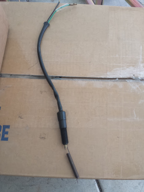

I installed the switch and wired it.  It worked as designed for about 5 tries and then stopped working (I was pissed!).  After doing a little research, I decided to go with an hydraulic brake light switch.  Since I had my rearset brackets off the bike, I decided to replace the rearset arm with a straight version and a rubber brake pedal.  I love the way it turned out.
This setup worked like a charm!
The front brakes were the next source of my frustration.  I could not get the front brakes to bleed for nothing in the world.  After hours of cursing and trying to force brake fluid through the system, I figured out that the master cylinder was bad.  I ordered another off of ebay and as soon as I pumped fluid through it, everything worked like it was suppose to.
Next, I go to wire up the front brake light switch and noticed that it constantly stayed on.  I checked my wiring and found the problem.  Everything worked like it was suppose to, with the exception of the cheap brake levers that I bought on ebay.  The lever never made contact with the OEM switch.  Even though these were supposed to be direct replacements, they were just cheap Chinese copies.  Luckily, when I ordered the new master cylinder it came with an OEM lever.  I installed it, and what do you know, it worked like a charm.

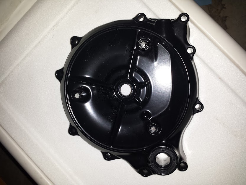

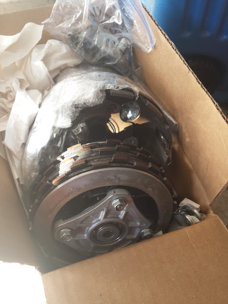

I decided to tackle my clutch next.  I read the service manual, read Hondaman’s book, and watched youtube videos, but I could not get the clutch to disengage for nothing in the world.  I looked at diagrams and had everything together like it was supposed to.  After 4 tries of taking the clutch basket out and replacing it, I finally broke the clutch plate.  This actually turned out to be a good thing.
In 76 and newer models (I think), Honda designed a double steel plate that is supposed to quiet down the clutch.  I didn’t have one, so I went back to ebay and ordered a new clutch plate and clutch basket.  I found one for about $30.
Once I installed the new double-steel plate, I reinstalled my clutch basket and guess what?  It still didn’t work.  I went through the roof.  I was so pissed off and frustrated with this bike.  After a few days I came back down to my garage and pulled the clutch basket again.  Since I had an extra clutch basket, I decided to compare both of them to find out where I was going wrong.  Then a light bulb when off!  The new clutch basket that I had ordered was a little bigger than the one I originally took off of my bike.  So I used the new basket, put my clutch back together and it worked!  Calj737 got a good laugh out of it when I was talking to him on the phone.
I had my clutch basket cover powdercoated with the rest of the covers on my bike.  They are the exact same color as the rest of the frame
I also had the outer clutch cover from Joker Machine powdercoated the same color.  The kick-start shaft cover is also a nice touch!
I also installed a oil pressure gauge with a Joker Machine bracket.  The points cover is also from Joker Machine and is powdercoated as well.  It is currently only sitting there.  I’m waiting for my Dyna 2000 ignition to arrive.

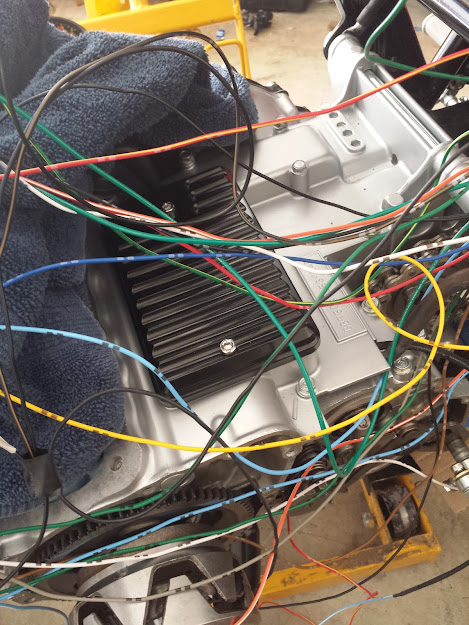

I’ve also taken the time to start working on the wiring.  Right now I’m just doing a dry fit.  After I get it all worked out, I’ll solder all the connections and neatly clean up my harness.
I started with a Antigravity Battery, Motogadget M-unit, and a new Rick’s Motorsports’ REC/REG.  It took some work, but I got them to install neatly into the Benjie’s tail section.  After many headaches and finally contacting Cal, I was able to get everything to work as it should.
Don’t mind the mess.  It will be cleaned up when I get everything finished.
This is a quick connector from the battery that is neatly tucked behind my license plate in the bracket.  This way I can charge my battery without having to remove my seat.
If you look closely, I mounted the horn in between the frame.  It fits nicely under the tank and out of sight.
Wires are everywhere!  But, like I said, it will be cleaned up after its all sorted out.  After looking at all of these wires, I’m seriously considering ordering a Motogadget M-Button.
Like I said, everything is working as it should.  The brake light, headlight, turnsignals, horn and the starter.  I have the M-unit setup with the exception of the alarm, but I’m not going to start messing with that until I get my bike finished.
Check this out!
My gauge is gorgeous and it works like a charm.  All the idiot lights work like they are supposed to.  I have the neutral and oil pressure lights working.  I am very happy with the way it turned out.
I do have one question about the kill switch (maybe Cal can answer this), on these old bikes does the kill switch disable the starter like on modern bikes or does it just disable the ignition switch?  When I was messing around with it, the switch did not stop the starter from turning over, but it killed everything that I had plugged into the AUX port on the M-unit.  Is that it’s only function, to prevent the ignition from starting the bike?
Here is my starter cover.  As with the rest, it is from Joker Machine and is powdercoated.
The only thing that I’m waiting on is my Dyna 2000 ignition and I will finish up the wiring.  I still need to connect the alternator wires and the Regulator/Rectifier.  Then I can move onto soldering everything up.

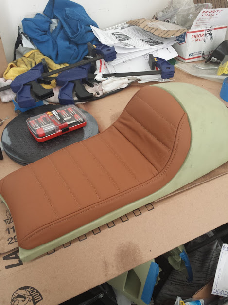

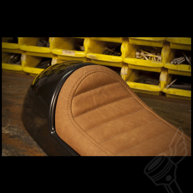

As I mentioned, I got my seat redone to match my grips.  I’m a little on the fence about it.
I wanted something like this:
But I got this instead
This is not what I wanted.  When I took the picture to the guy who did it, he said that it would be no problem at all.  But when I went to pick it up, he made all of these excuses about why he couldn’t get it to turn out like the picture.  I was so pissed and he knew it.  So he only ended up charging me $50 for the job.  I bought the leather myself from a local shop here in San Diego.
After seeing the seat on my bike, it actually doesn’t look bad.  BUT, it is not what I wanted or the look that I was going for.  Because of this, I’m on the fence and I am debating on whether or not to leave it or to go somewhere else and have it done over.

Holy cow what a build!  You sure went all in on this one and it is turning out great!  Any concern about using a fiberglass tank?  Also, love all the motogadget stuff.
Definitely get that seat redone, you have put this much money and time into it why let it be "incomplete"?
Re: Bigsam302's 76 CB750F w/GSXR Forks: Project Helen - Project back on track.
« Reply #35 on: February 16, 2015, 05:43:14 PM »
At least the upholstery is leather -- versus faux leather.  I think the seat turned out pretty good.

Sam - From the START output, you run a wire to the KILL switch, then from the KILL to Solenoid. This way, the KILL must be in RUN to allow the Solenoid to get power. You could go from KILL to Coils and power/disrupt power to the coils if you prefer that method, but you would substitute START output with AUX. So, AUX->KILL->Coils is the other method.
The START button will start with a single push, and KILL with a double-push. Thats functionality built into the m-unit.
As for the CONFIG button you have wired, its a clever idea, but impractical a bit. You'd have to see the actual m-unit while changing configs and setting menu options for it to be of value. Not really viable unless you're in the garage..
As for your horn, its a tidy location, BUT, it will greatly reduce the audible effects of it. Up to you if you care/don't care, but its pretty ineffective pointed and mounted that way.
Cal,
Thanks for the advice.  I'll try running the START output to my KILL switch like you suggest.  Do I also tie together the wire that's coming out of the AUX to the ignition to the kill switch as well?
I understand exactly what you mean about the CONFIG button.  I ran it this way because when you buy the M-switch, it has two buttons on it.  I only needed one for the speedo.  Since I have an extra button, I decided to run it to the CONFIG port so I will not have to touch the wires again.  I just need the pop the seat off to make changes, and I can do that on the fly if I decide to change something while I'm out.
I also get what you are saying about the horn.  Yeah, I wanted to mount it somewhere else but I don't have room on the front of the bike because of my oil cooler.  The horn is loud so I really don't see it making that much of a difference.  I'll wait until I get the engine in and look at moving it.
I echo the concern regarding a fiberglass gas tank.  Make sure you line it with Caswell's and keep and eyeball on it.  Ethanol loves to eat the resin in fiberglass.
CB750 Fan and Callmejarob,
See, this is the issue that I am running into.  The seat does not look bad, it actually flows good with the bike.  But it is not what I wanted.  Could I live with it? Yes.  I think that I may sit on it for another week before I make my final decision.

Either the KILL wired from START output will de-power the solenoid, or KILL wired from AUX will de-power the coils. Which do you want? The electric start button depressed twice will stop the bike, but it's not a true "KILL". Pressing the start button again will restart the bike. Make sense?
Ok, Cal.  I got what you mean.  Thanks for clearing it up for me.  I'll probably just go with killing the START output.
