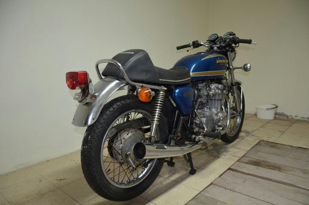

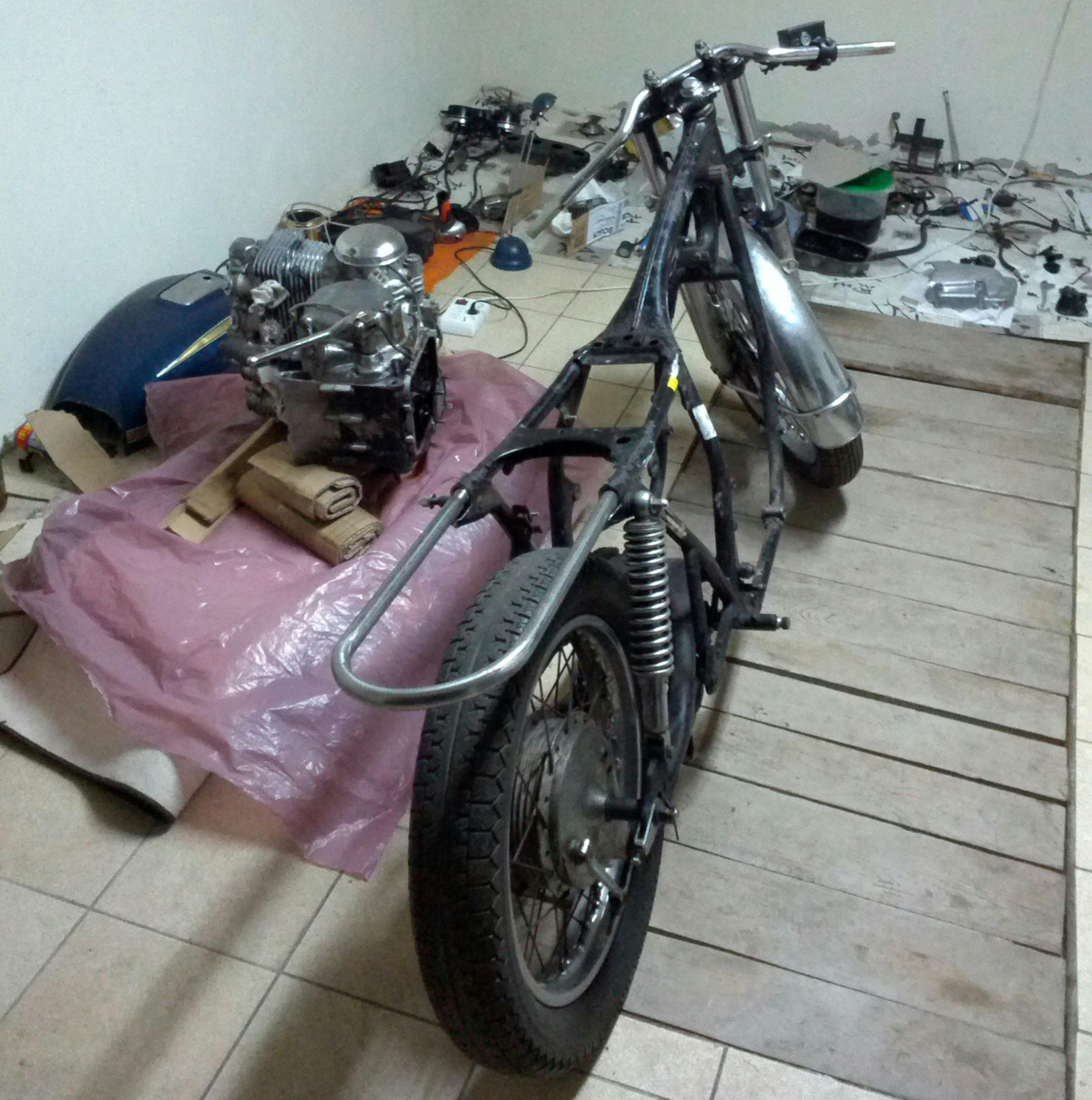

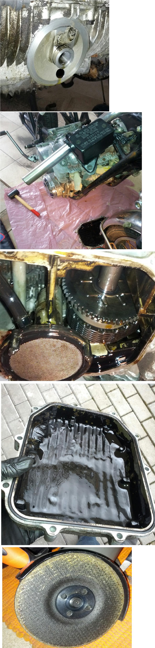

Hello everybody !
I've been a SOHC reader for some time now, and I want to share with my bulid. It is still in production phase, and now I am going to assembly stage. I will have a lot of questions, but as far as I saw - It is the best place to ask :) A little background of mine - 24 year old motorcycle enthusiast, almost no mechanical background, pretty fast learner though. Let's start - I've bought a 1978 Honda cb 550 F Super sport with a 16k km. It was in a barn, but didn't look that bad. I imported it from Netherlands. As soon as it arrived, I've changed oil, rebulid the carbs and let it run (started after 2 spins, no smoke from pipe - excellent). After that - full disassembly. Feel free to comment and help :)
Video from startup (-5 C degrees outside)
Offline simonpol
  • Posts: 14
Re: CB 550 F Super sport - Let's make it pretty
« Reply #1 on: November 15, 2014, 03:20:38 AM »

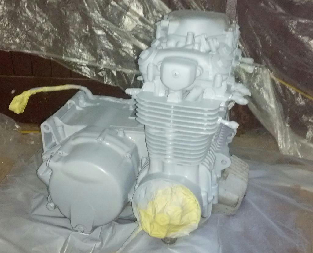

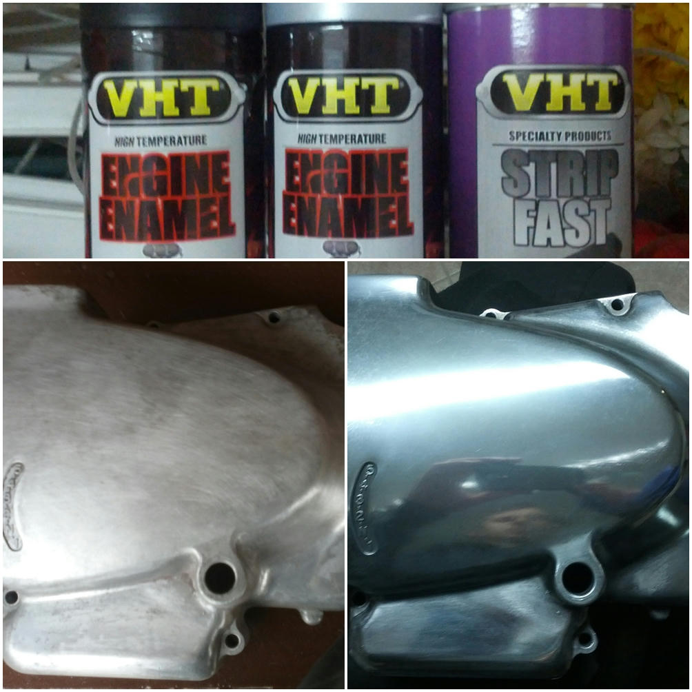

So, the crater that You can see near the oil filter hole is a mystery, but it does not affect engine work. In the oil filter pan there were no metal flakes or so, only the black „mud” which probably is some leftover from staying in a barn too long.
Greetings !

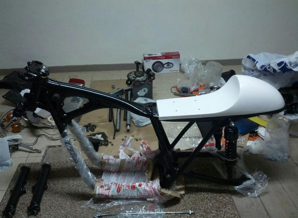

« Reply #2 on: November 15, 2014, 04:57:48 AM »

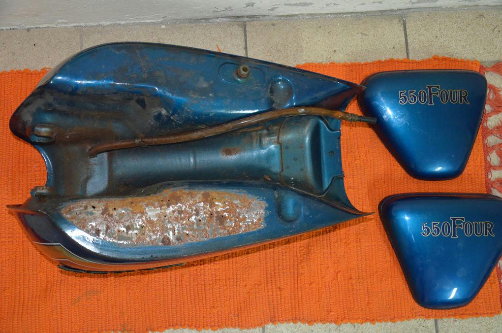

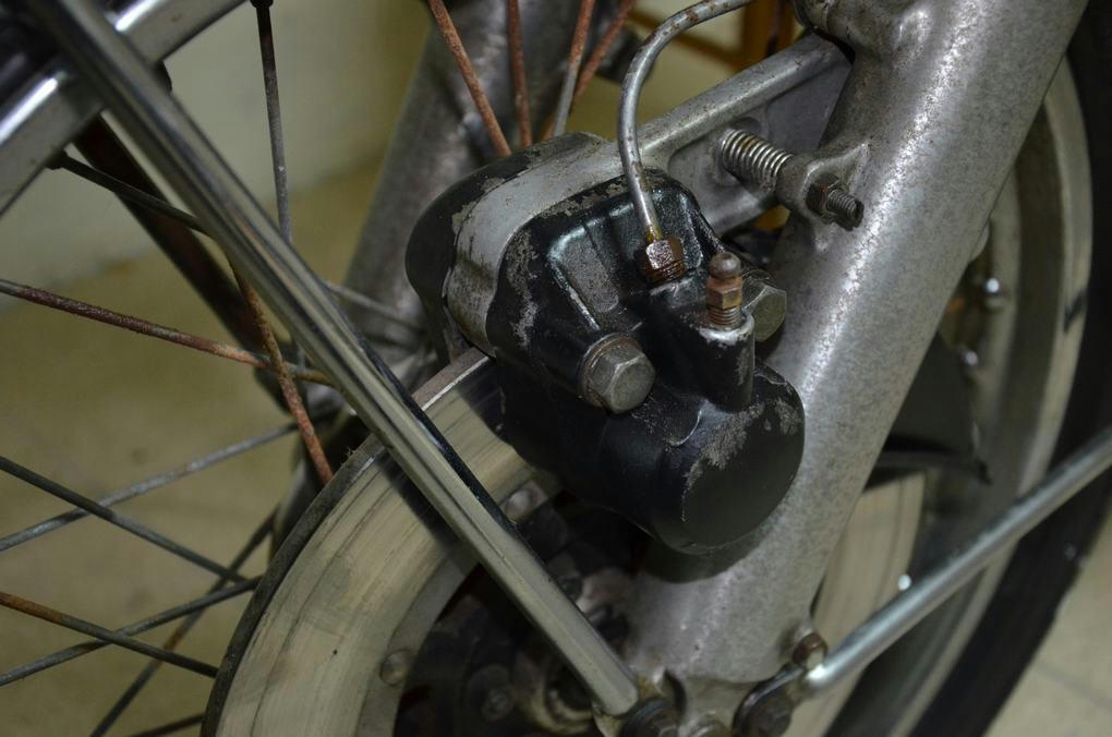

I've already bought the steering head bearings - tapered. But in the set they were no rubber dust seals (nr 5 from http://www.cmsnl.com/honda-cb550f2-super-sport-550-four-1977-germany_model17124/partslist/F04.html#results ). So should I make/bought one ?
Yeah, I was thinking that it would be good to replace the swing arm bushings.
Wheel bearings were examined very closely and the guy who was helping me with that said that they are in a very good condition. They were cleaned and lubed. They don't give any noises or sth.
The brakes are a long story. I've bought a rebulid set to original pump. But after rebuilding it the last seal cracked. So I have to do it again. From the pictures You can see that I've bought another master pump from Suzuki. After that I've read on a forum that hydraulic ratio is important and it occurred that the stock pump will be better. The brakes were stuck and full of dirt. The cylinders are in a good shape, i will post a photo. The seals have to be replaced. The SOHC forum has a lot threads about dual conversion, so I think that there's a lot reading to do :)
I dont think it's chem, but it is different (like You said). The rear is 4.00 Roadrider and front is Michelin Pilot.
The tank will be a tough mission. It has some holes but all in all the metal structure is in great condition. I've knocked the places with holes with hammer, even tried to cut it out with grinder but I have to give it to the welder. He will make patch and after that I will de-rust.

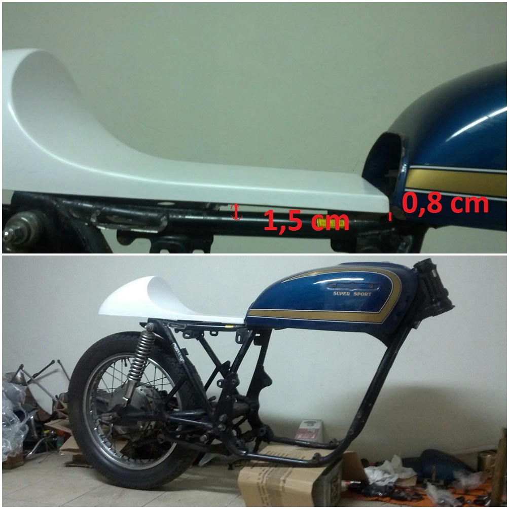

I will be running a single LED strip as a taillight, clipons and a seat can be seen on one of the photos (I will post it when it will be placed).

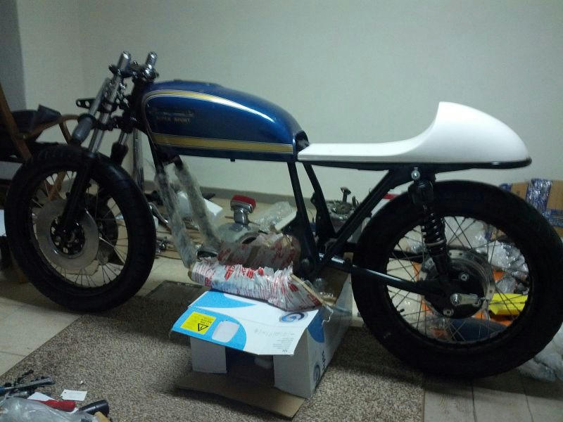

« Reply #6 on: December 14, 2014, 05:15:16 AM »

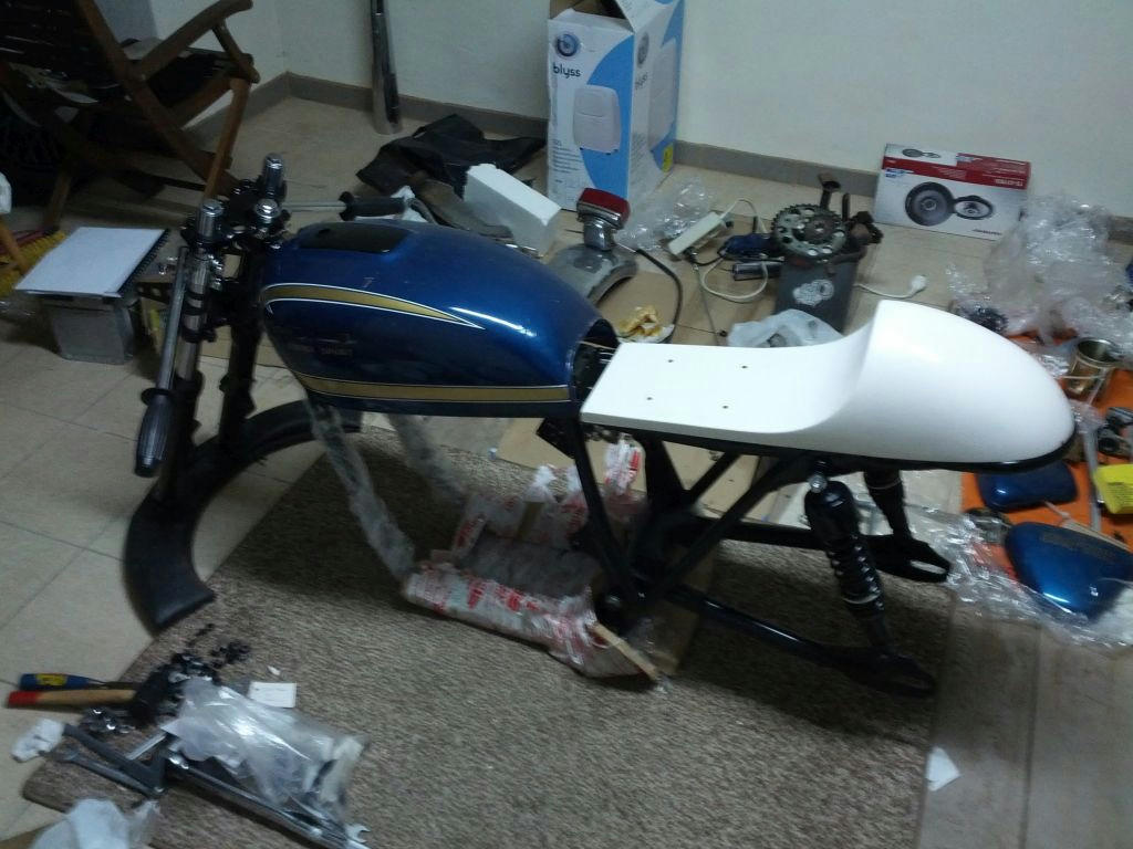

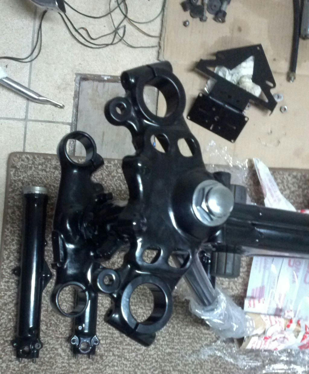

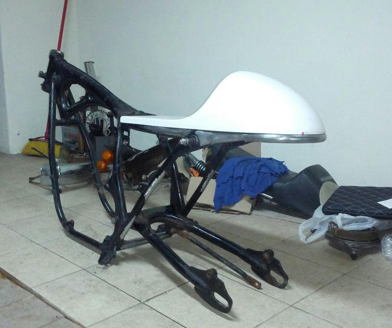

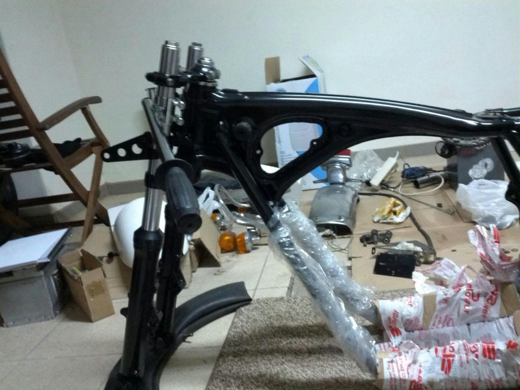

Hi everyone!

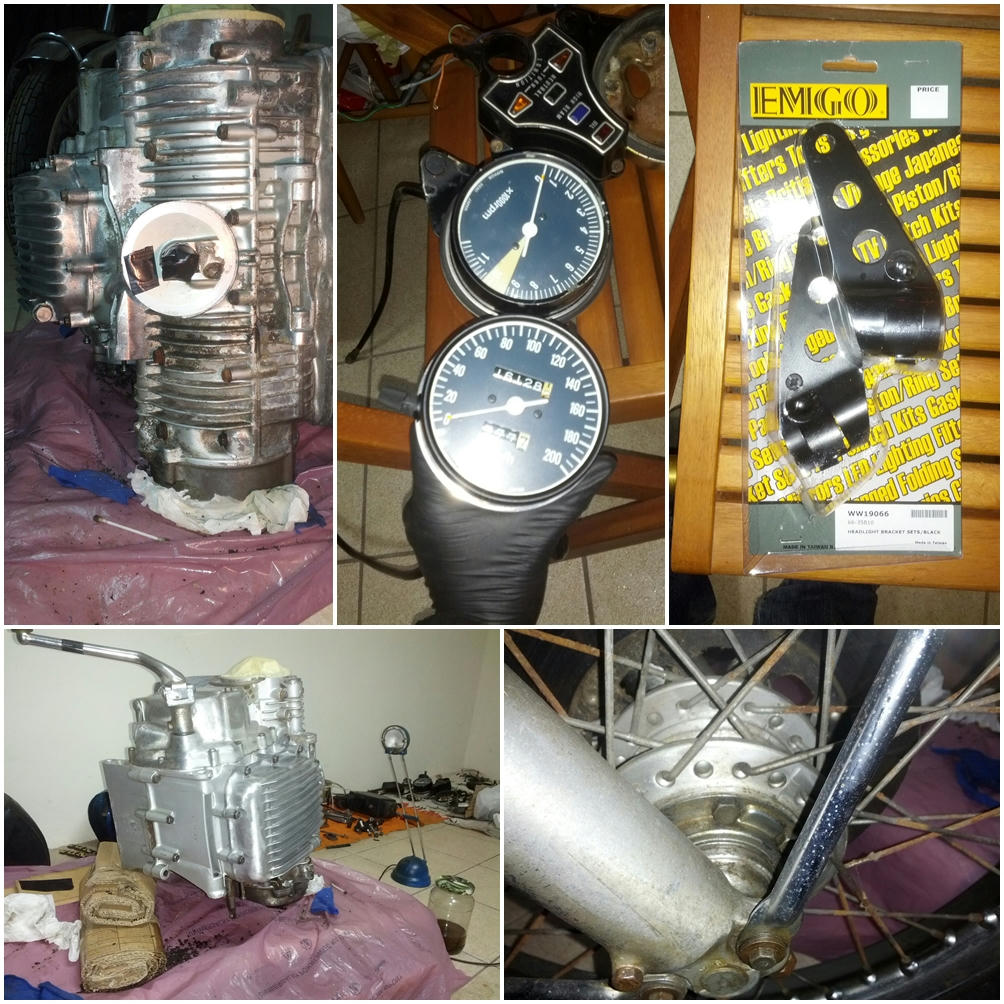

So I've managed to put the bearings inside the steering head and the swing arm took his final place. Now I've got some tough decisions to make:
a) What chain and sprocket put to Honda - 15-37 vs 17-37 DID/RK/JMT ?
b) I'll be running only rpm meter so I have to manufacture the mounting.
I like the way the white seat mixes up with black chassis, Maybe "white" is the answer ? Sorry for the mess on photo - busy time.

this promises to be interesting. i live in the netherlands and looked at quite a few 550F's before settling on my F1. wonder if came across yours, during my search?
re. the wheel bearings: i'm with calj737, replace them while you're at it together with all other bearings. the old honda ones were not that great to start with and it will give you peace of mind. renew the suspension as well (springs, seals in fork and make sure those rear shocks are in good shape), it will give a much more confident ride.
do you have the cover for the airbox?

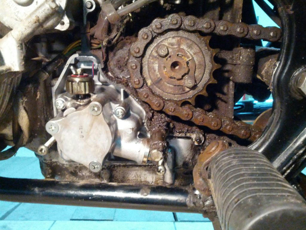

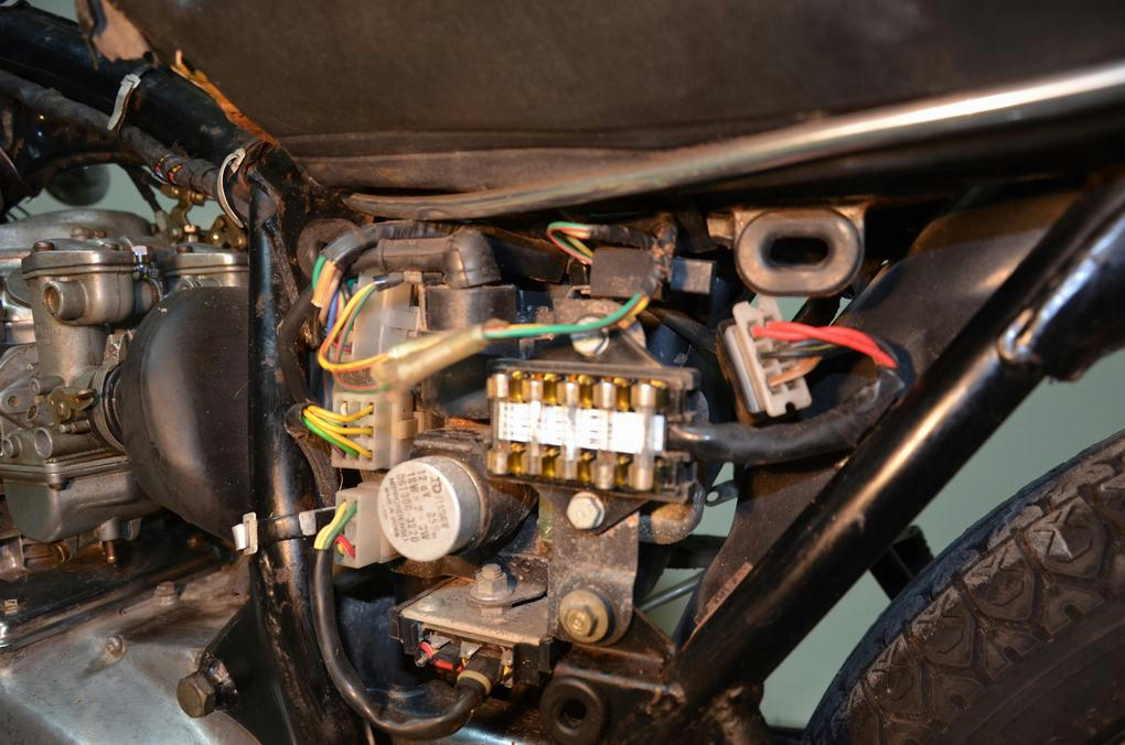

A couple of observations:
In an earlier picture, your speedo gear is on the wrong side, it goes opposite of rotor.
Might want to remove the paint/powder coat from inside the triple tube, it could make them too tight to slide the uppers through.
Remove the paint from the frame where the engine mounting bolts pass thru at the upper rear, this is where you need a full bare metal ground.
Looking good!
1) I can't udnerstand - what is on the wrong side ? It is the same like on the first pic in the thread, but the second disc plate is added. I can take some more photos to clarify.
2) My friend said it is better stretch the tube while inserting the tube instead removing the powder.
3) That's a good tip ! Totally forgot about it.

When you reassemble the forks don't forget the little washers with one side flattened. They fit in the gaps on the top triple and prevent you from overtightening and cracking the triple.

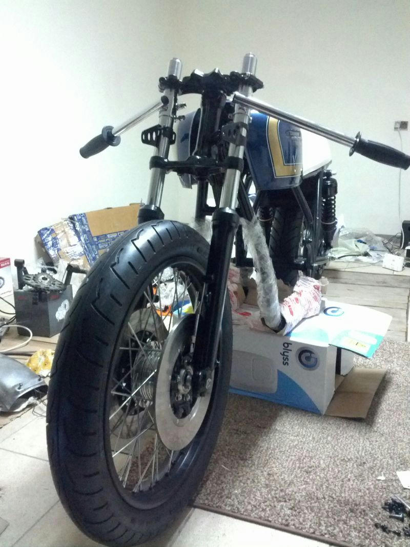

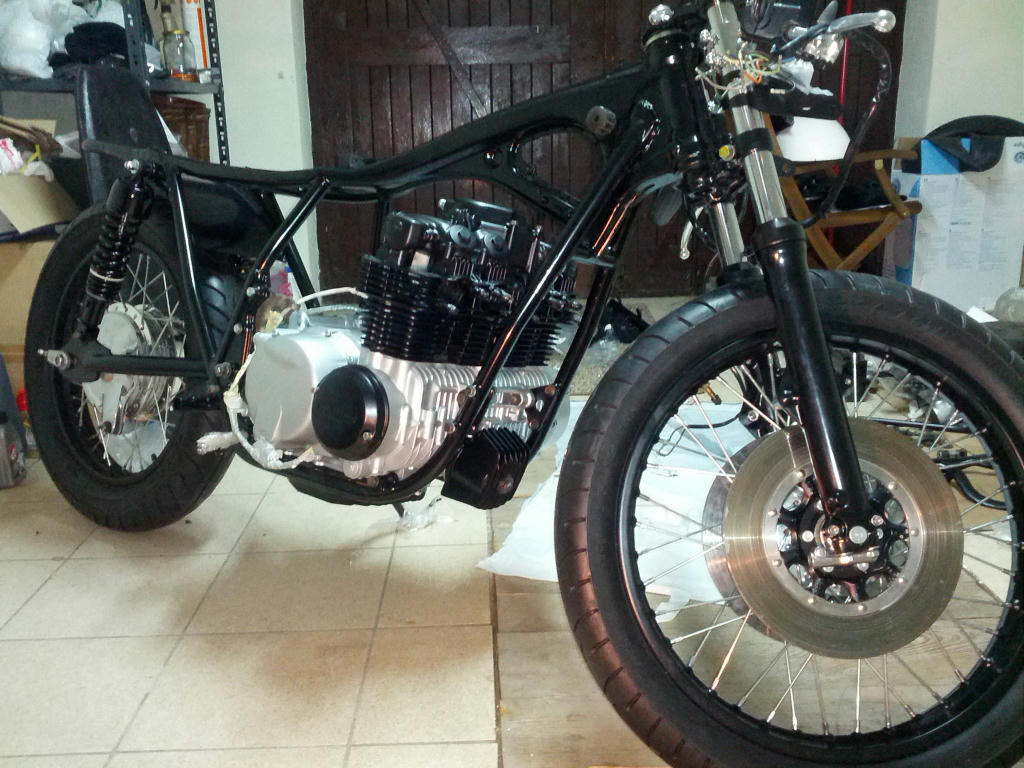

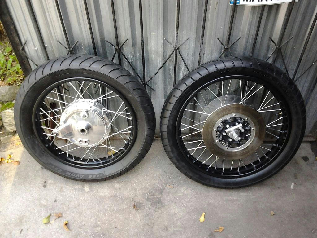

I've managed to put the forks in place, so in a close future I will install both wheels. Unluckily, I have big problems with buying the sprockets - the 16th tooth front is unreachable in my mother country. The 15 tooth version is too much hardcore for me, so I will arrange the 16th version from abroad. When wheels and sprockets will be done, I want to mount the engine in place. That's unbelievable how much time it takes to do the simplest things in garage. The tank and seat are not aligned yet - it is just for photo reasons :D
Edit:
Today I wanted how does it look with wheels - I like it.
« Last Edit: January 07, 2015, 11:45:48 AM by simonpol »

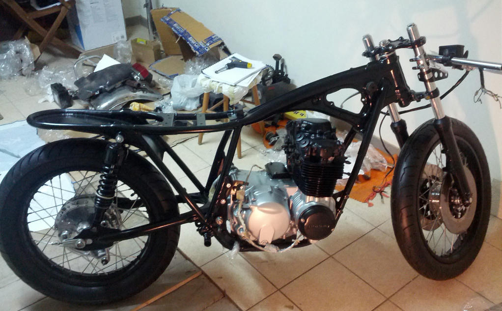

« Reply #14 on: February 21, 2015, 06:15:50 AM »
Hello everyone after short break.

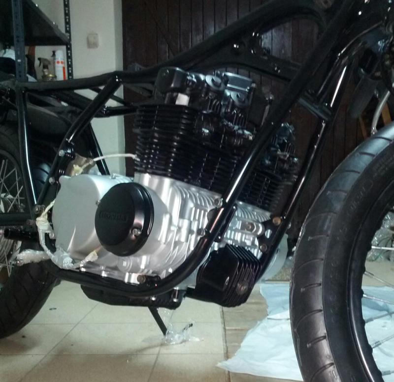

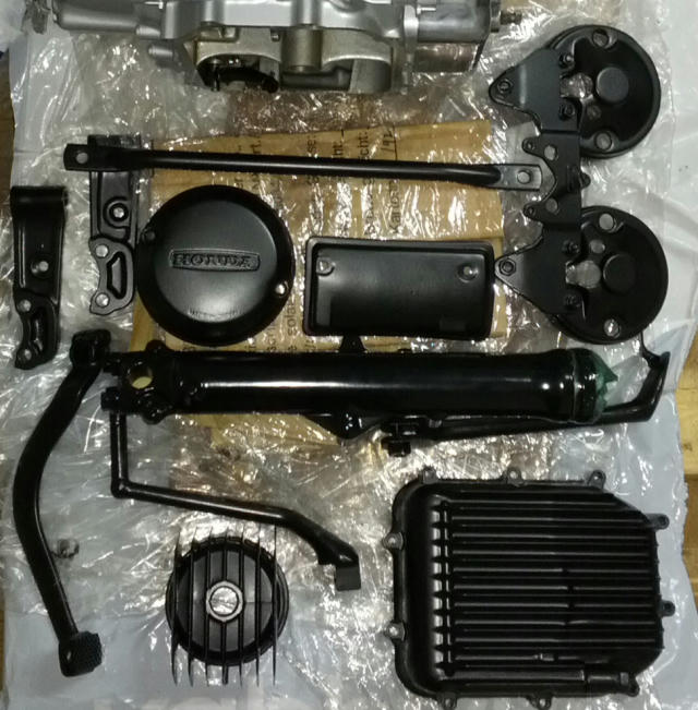

The engine is in place. I've decided to mount it using old bolts because the spring is coming and I don't have enough time to collect them in time. After this season I will replace it on winter evenings  ;)
Sadly, I've lost one important bolt - engine rear lower bolt hanger 90107-390-000 and it has to be machined. Can someone post the parameters of this bolt ? I know it's M12 but it would be great if I can get total width, and thread parameters.

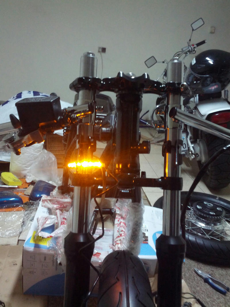

This is how it looks for now plus extra I am posting blinker proposition - just LED ring.

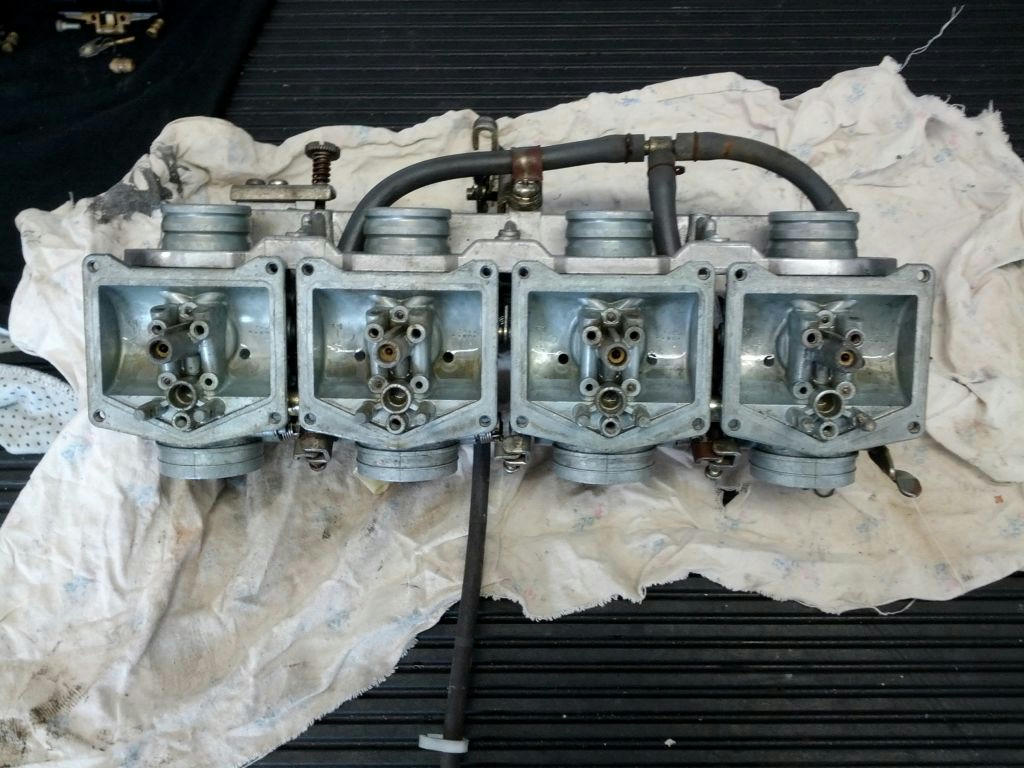

The carburetors are technically rebuild, but visual perfection will be achieved next year. The same goes for buttons and switches. Now I am going to do some electrical check.
Stay tuned !

Today I've installed carburetors and air pods. I didn't take any measurement before buying those, so I ended up with cutting the rubber joints and being unable to turn on the choke  ;D ;D ;D But I guess I can call it a day.
