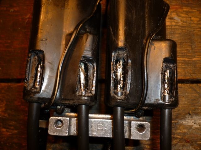

« Reply #6 on: November 23, 2014, 01:37:17 PM »
This is how I do mine. Solder the ends and fill with RTV.

« Reply #7 on: November 23, 2014, 11:07:29 PM »
that's a neat job!i use 2 pack epoxy though.
