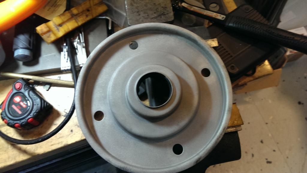

Hi Guys,
I want to refinish the Sprocket side cover.  I have it stripped, but there is a rubber seal that I don;t see how to remove, and even if I did, there would be no replacement available.
Has anyone disassembled one of these before?
I could paint it, but i would rather PC it if possible.

Just for clarification, here is what I am talking about...
Front Side
Back Side
As always....  any help...
Dagersh

You can remove that seal and replace it. It should have the part number or dimensions marked on it. (Xmm  X Xmm X Xmm)

Awesome -
Best way to remove it?  Seal puller?  Does it go in from the backside?

I just did mine. That seal pops out with a flat head and a new one can be had from bikebandit or honda. I actually only cleared them in powdercoat to protect my distressed look. Ironic.

Thanks guys,
It did indeed literally pop out at a touch of the puller.  Although I am glad I asked anyway.
On to the PC booth!
