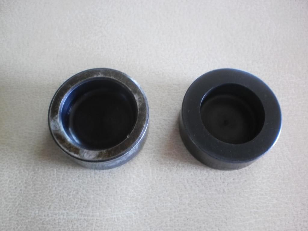

Hi,

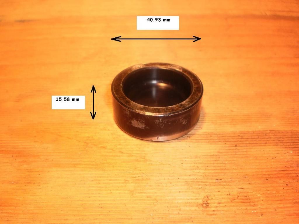

The grimeca front brake on my Morini 3 1/2 Sport began to bind the other day, so I stripped and cleaned the caliper.  The caliper is in beautiful condition, but the pistons are a bit pitted.  I searched everywhere for replacements, but it turns out they are rarer than rocking-horse poo.  I managed to source one.  So, I am wondering whether there is someone out there (preferably in Melbourne, Australia) who can use their lathe to make a pair for me out of stainless.  I can send the piston for measuring purposes.

Based on the picture, that appears to be a usable part to me. It looks like the coating or anodizing is worn off in spots, but not much worse than the pistons in my Grimeca the last time I had it apart. A good, but gentle, cleaning of the bore and o-ring groove should cure the binding.

The photo is deceiving.  The pitting on one of the pistons is quite bad.  The other one I could probably get away with.  Two new pistons in stainless would be the bomb

Are your pistons alloy?
Offline Trevor from Warragul
  • Posts: 1,119
Re: Grimeca caliper piston
« Reply #4 on: January 25, 2015, 08:36:11 PM »
Steel
« Reply #5 on: January 25, 2015, 08:49:52 PM »
That is not anodized aluminum?  Is it black oxide steel?

Here on the other side of the world there's a lathe that mostly works and  some disc shaped scraps of stuff around, bar stock that might be that big.  Not all of it is stainless but some is.
It's seems like you would want your machinist to have both halves of the part.  If things don't work out locally try to pm and I'll ask the machinist about it, but it would be kinda shooting in the dark without a few other measurements.
Is there a step on the end/  ball cutter  size for the inside/ thicknesses/.

Steel
Bugger me.  I just checked & they are aluminium.  What the heck caused the pitting?  It looks like rust damage...

« Reply #8 on: January 25, 2015, 09:47:42 PM »
Brake fluid is nasty corrosive stuff.

« Reply #12 on: January 26, 2015, 12:38:34 PM »
have you had a look at brembo pistons , you can normally find one that will interchange with a grimeca piston
brembo  also do pistons in alloy and are much easier to find
if not any good machinist will make you a couple , brake fluid does not damage alloy but to protect them from the elements it is worth getting them anodised

Boy, I'm now an expert in Grimeca calipers!  Mine is a 1010, this was superseded by the 1025.  The 1025 pistons (pucks) are also 41mm, and should fit the 1010.  I've found a source for a 1025 caliper rebuild kit, and one is on order...

« Reply #23 on: January 31, 2015, 08:02:15 PM »
The 1025 rebuild kit arrived (on a Sunday) & the pistons (pucks) & seals are a perfect fit.

« Reply #24 on: January 31, 2015, 08:28:14 PM »
The new one looks like a little bit more mass to it.   That set is aluminum also?
