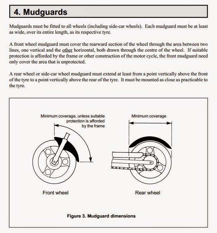

oh, didn't know there were regulations for the length of a mud guard :)
to bad!
These are the regulations we have to abide by. Some people don't and they run either no guards or small ones. Its not worth the hassle of having to pay a fine and get the bike changed back for an inspection. For me anyway.

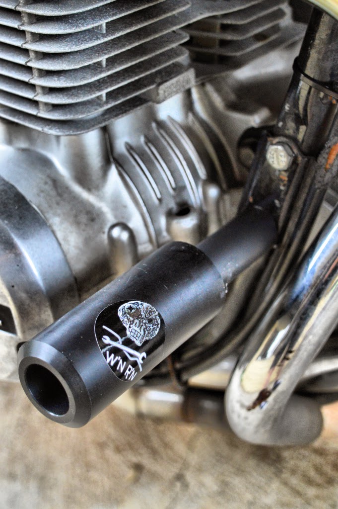

I'd shorten the rear fender if I were you and ditch those engine bars ;)
Engine bars for sure are coming off. They will be replaced with some crash knobs made from skate board wheels.
Installing frame sliders is not a bad idea.  However, I don't think that skateboard wheels have the same abrasion resistance of Delrin or sliders with more robust material.  Remember that you want something that can support the force of a 220 kg (485 lb) motorcycle plus its inertia.  I don't think a skateboard will hold up to that abuse.  It will likely tear apart and defeat the purpose.
Noted about the skate board wheels. I have ordered a set of universal frame sliders.

Crash bars are gone. Crash knobs will be added soon.

Converted/mashed/cut up some CBR600 crash knobs in place of those horrid crash bars.

Removed crash bars that came with te bike. Replaced with CBR650 Crash Knobs.

Skateboard wheels are polyurethane and can be had in up to like...shore a 101 hardness...  plenty hard enough for a layover. My guess is that it would abrade like sandpaper more than "tear apart"
