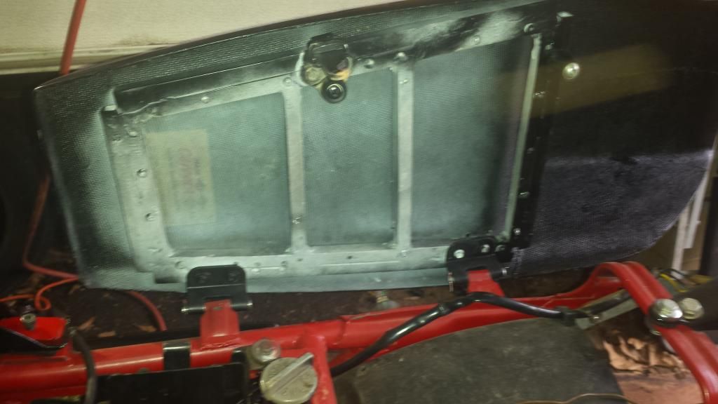

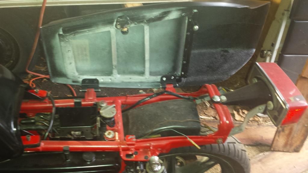

I have what you need here. It's a sub frame to which you can mount your stock hinges to And your seat pain will bolt right up.  Let me post a picture-

« Reply #3 on: April 06, 2015, 06:31:22 AM »

« Reply #4 on: April 06, 2015, 06:33:02 AM »
Also have one for sale if interested .shoot me a pm if you want it.

hey 78whiteorbs, that looks great. I forgot to mention that my bike is a 400f, so your sub frame won't fit anyway. But thanks for the offer mate.

« Reply #6 on: April 07, 2015, 05:51:14 AM »
I actually own an 350f  which has an identical frame(in the seat area). All you would need to do is move the hinge mounts relative to the subframe. Pretty simple And I don't think you are gonna find a solution that allows you to not cut/ remove hinge mounts from your frame and permanently alter . They make a few fiberglass pans with designations for the hinges and key latch to mount for the cb750 I have seen (think Steve carpenter sells them) but not for a 400f. Goodluck and if you find another solution please post would love to see.
