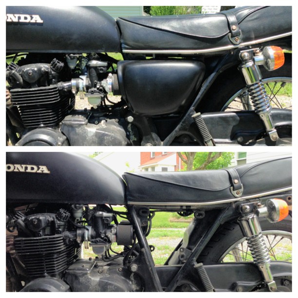

I did mine with stock harness, didn't extend anything. Oregon reg/rec combo, ballistic 8 cell, remove starter and solenoid.

And yeah, you don't need to do anything fancy or make a "box". I just cut a straight piece from a license plate, bent one of the sides up, and bolted it on through existing frame holes.

Welp. Now I want to try this. You bolt both sides down? How much of it can you see from the side?

Yup, you can see both bolts in the first pic. Can't see it at all.

wow. So much cleaner than I had anticipated. I can skip that 45$ box altogether and go this route! Now to score a used plate haha.
