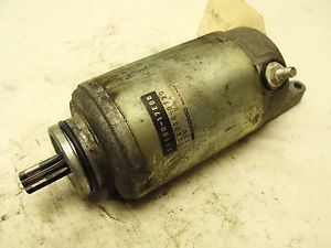

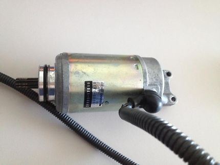

  • Posts: 19,235
Re: Stronger starter options for high compression or big bore motors
« Reply #19 on: April 15, 2015, 03:04:54 PM »
I was looking at a GSXR starter motor yesterday, it looked almost the same as the Hayabusa starter but the wiring was in a better position. I might just take a 750 starter to a bike wrecker and troll through the starters and see just how many might work with our bikes...?

  • Posts: 19,235
« Reply #22 on: April 15, 2015, 05:46:09 PM »
Any starter from a 1980-1983 DOHC will work.  This includes the 900 and Cb1100f.
... cover will fit , wont fit with GSXR.checked up on GSXR , one i have is 750 , dont know if 1100 is same ?,or higher output ?
As far as i know, there's two different out puts on the DOHC starters, the early ones aren't as powerful as the later ones.. ;)
The GSXR one I saw yesterday had the pin and bolt further to the side, rather on top, like the Hayabusa starter...looked like it would fit in the case...?  I'll try find out what model it came from..
  • Posts: 19,235
« Reply #23 on: April 15, 2015, 06:00:22 PM »
Her they are... ;)  these were common on most 1990's GSXR1100 and 750...
