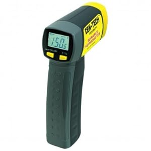

How do I check pipe temps?
If you do not have a fancy non-contact thermometer, feel them with your hand as the bike is first warming up.  You'll be able to tell if some heat up more quickly than the others after just a minute or so.
If the pipes are already hot, fold up a wet rag and touch it very briefly to the pipes near the head.  You'll be able to tell from the sound of the sizzle.
Having acquired a number of small burns from hot pipes over the years, I now use a non-contact thermometer  ;D
