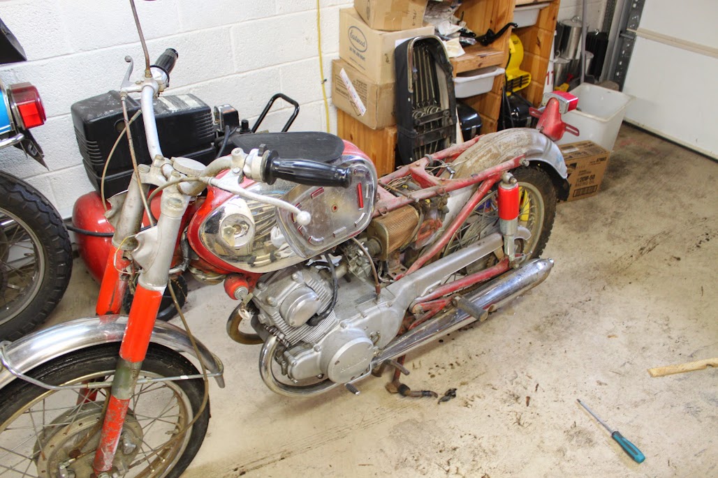

I bought a 65 CB160 about a year ago, in really rough shape.
Not running(with suspected engine problems), no title, no headlight/speedometer, broken starter, rusted rims... anything metal looking has some sloppy aluminum paint haphazardly applied on it, and the speedometer cable was just hanging off the front wheel.
What's a bike like this good for besides parts... I say race bike!
So my buddy and I spent some time tall talk'n about how easy it would be to convert this into a race bike.  Well, in hindsight, that time a talking was precious time being wasted.  I race with AHRMA, and we're planning to be at Grattan in mid-June for our first race of the season.  Plenty of time, right?
We started the tear-down in late January, doing a little work here and there, and then started picking up the pace around late-February/early-March, and now we're feeling the pressure in April.
Here's a couple pictures of the bike as we're starting the tear down (I think we only removed the seat and side covers at this stage):
