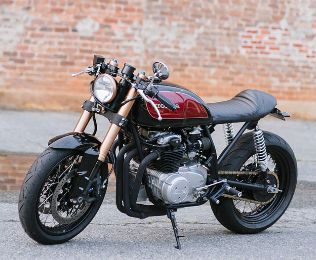

The eventual goal for Logan's bike will be something that we hope to have look something like this one...which is one of the bikes that I believe Devin from CognitoMoto did:

Do you think you'll do the inverted forks too, Ron?
cal, I love the look but I think the inverted forks are above my skill level.  On the first one, we probably will go with the single front disk as well but on Logan's bike, we'll do the dual front disk.

Ron - inverted forks are easy, actually. Devin @CognitoMoto makes it even easier. He sells steering stems to swap the new front end into the stock 550 neck, plus, he sells his front hub that is perfectly set up to lace a rim (17",18" or 19") to the front end and you use the donor rotors and calipers. Leave the rear wheel as is (stock hub) and away you go.
If Bill have the CBR front end, calipers and rotors, just contact Devin for the hub and stem.
http://cognitomoto.com/collections/fork-conversion-parts/products/cbr1000rr-2004-2012-hub-bolt-on-conversion-laced-wheel
http://cognitomoto.com/collections/fork-conversion-parts/products/cbr600rr-cbr1000rr-fork-on-honda-cb750-frame-conversion-stem
http://cognitomoto.com/collections/cognito-moto-originals/products/triple-clamp-with-monoscope-mini
That last link is a custom top clamp spaced for the CBR front end, with an integrated MotoGadget multifunction gauge and instrument lights (LED). OF course, you should also install a steering damper (and thats usually found stock on the CBR). (Call me, I'll drive down and we'll wire you up in no time.)
Easy as can be. Then Logan will have a "custom" bike, upgraded handling, braking, and fit his preferred style. The gauge is electronic, so you can abandon the stock speedo drive gear and stock mechacnial tach. Clip-ons are best suited for this application.
What else do you need? Rearsets? He's got them. Seat? Widely available. This bike should take less than a week to build now that you've got your list and suppliers.
