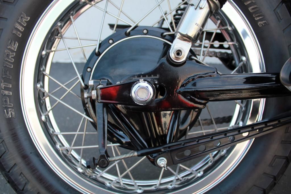

Well, I found a set of aluminum Akront rims on eBay Australia. Polished them with Mother's Mag and Aluminum Polish last night while watching TV and I think they turned out very well. Check 'em out...
The rim holes do seem to be slightly larger than on the stock rims, but in my mock up the spokes I purchased from Z1 seem to be doing what they're supposed to do, however the nipples are not as snug in their respective rim holes as on the stock rim.
A question for you wheelwrights:
How much play, if any, should there be around the spoke nipple in its rim hole, prior to tightening?
« Last Edit: May 30, 2015, 04:30:29 PM by Imago »

Those are drilled for .28" not .25 which is stock.  The extra space does matter.  Nipples need to be snug to provide proper support.

Thanks Chewy. My neighbour has a pair of digital calipers; tomorrow I'll measure the rim holes to ensure I get the exact and proper fit.
I did just spend $100.00 on a front/rear set of spokes/nipples from Z1.  I guess I can use them on another build.  :(
Re: Rims - How Important is Nipple Size?
« Reply #18 on: May 30, 2015, 08:52:15 PM »
You might be able to use washers to take up some of it. When you order from Buchanan so you get the option of several. Nipple sizes.

We checked with my neighbours micrometer, (he says it's commonly misnamed a caliper) and here are the sizes on random rim holes:
Old steel rear: .275 .276 .275
New Akront front: .256 .259 .260 .257 .261 .250 .255 .258
New Akront rear: .312 .319 .320 .314 .316 .312 .310 .315
I was surprised the new Akront rims were different from front to rear.
So I'm thinking different nipples are in order for front and rear?
