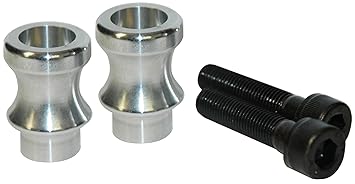

« Reply #277 on: February 24, 2017, 07:49:33 AM »
Wheels look great, very nice job with the polishing.
No stainless bolt in shock mount as they are weaker than a zinc plated.  Will you need standoffs in addition to the spools to clear the exhaust?

The spools have a little bit of a standoff to them, but if I need more I can always add a spacer.  I don't think my exhaust will be that long so I should be good.  I still have to see if my stand will reach up high enough to get to the bolts though.
