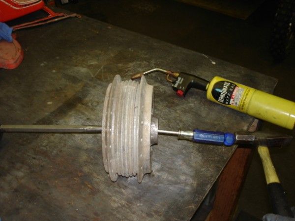

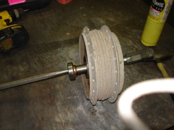

Got the bearing retainer out by spreading needle nose pliers putting one jaw in each slot and spinning.  Now cant get the bearings to budge but I just found this https://www.youtube.com/watch?v=t7VQnNfqJtA
You are on the right path. With all due respect to the slide the spacer over and use a punch recommendations it is far easier to use a couple of common tools to bang the bearing out from the center race. You don't need to usually buy a special tool or anything either. If you have an old screwdriver and a large drift punch you can wedge them in the center of the bearing and pop the bearing right out, heat helps out but you don't need a ton, maybe a couple of minutes on a propane or map gas torch.
Here are the tools you need, a large drift, an old screwdriver, a torch, and a hammer.
Here is a hub with the punch and old screwdriver jammed together from both ends.
Warm up the outer race a bit a one good wack on the hammer pops it out.
After the bearing is out simply wiggle the screwdriver and drift apart.
Just a side note here. For years I just used 2 old screwdrivers instead of a drift. Anything that will wedge in there will work.
