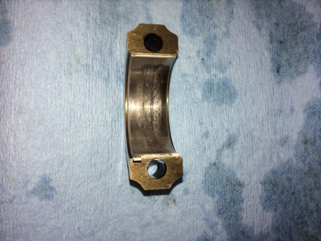

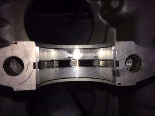

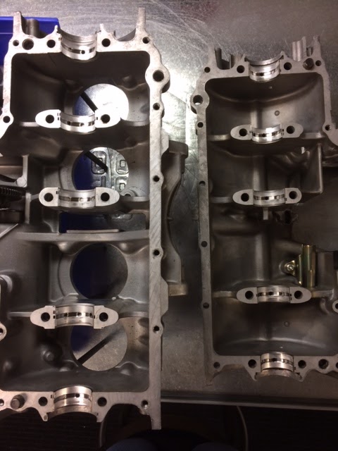

Time to get my Honda motor ready for the upcoming racing season.  The head is with Mr. Rieck for refurbishing.  Seems my valves were trying to occupy the same space at the same time and all needed replaced.  :o  Going with a different cam and Suzuki ignition with rev limiter to try and prevent it from occurring again.  Hoping with more accurate timing and air filters the damage to the head and pistons can be prevented this season.  Split the cases, here are some pictures.   This is the first time the rods have been off the crankshaft since I built the motor 2 seasons/10 races ago.  Checked the crank and rod bearings and all are around .002" clearance.  Still new to four stroke engines so I asked a friend who has been racing since the 70’s to take a look. He believes the rod bearings were too tight. That explains the dark mottled color. Also sees metal in the crank bearings. Good news no damage to the crank is apparent. Measured the rod journals and based on the chart in the Honda manual I was one to two sizes too small!  I think when I built the motor I replaced the old bearings with the same size new ones. Not sure I measured at the time. Think I got lucky not to spin a bearing or sieze one.
Here are a couple pictures:
Over view of the crankshaft bearings
Close up of upper crank bearing
Close up of lower crank bearing
Close up of rod bearing
Lower case with Plastigage on bearings, .002 clearance.  Standard value is .00079 to .00181, service limit is .0031.
Rods with Plastigage on bearings, .002 clearance.  Standard value also .00079 to .00181, service limit is .0031.
Also measured the rod side clearance and found three were .004+ and one was .007+.  Standard value is .0047 to .0106, service limit is .0138.  So well within the standard value.

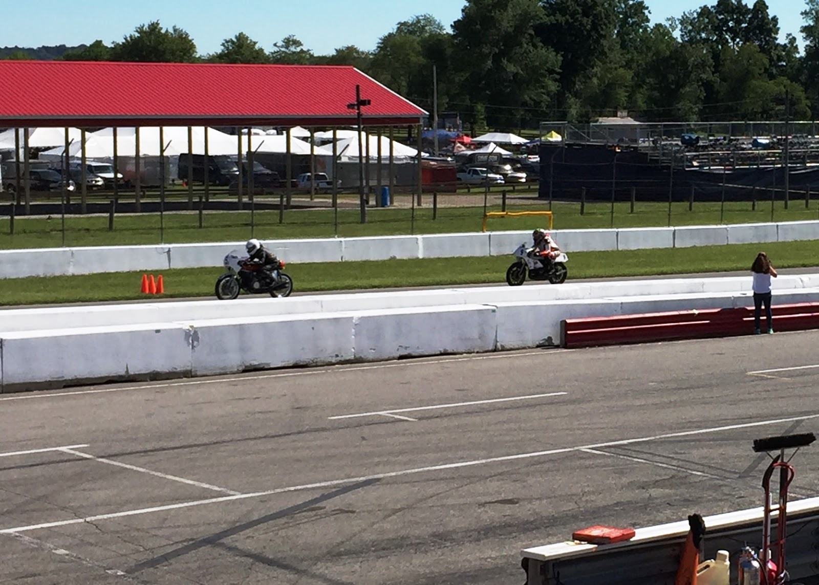

Two race weekends are in the books.  Added Gingerman to the schedule to shake down my new motor.  Changes from last year include refurbishing the head, new cam, and close ratio first and fifth gears.  The head work was needed as my valves were touching each other and corrosion damage.  The new cam has less over lap and I'm running some ethanol free gas with Marvel Mystery Oil through the engine after each race weekend.  Big thanks to Mike Rieck for saving my head.
Had never been to Gingerman and found it a challenge to learn.  Very flat and featureless.  The Honda was running well and like the new CR gears in the transmission.  Managed to get down to halfway decent lap times by race time Saturday and finished 4th in class.  Had a moment when a racer in another class came by and nearly took out my front wheel.  Was running 3rd at the time, but lost a position recovering.  Did not race on Sunday as I needed to get home and prepare my Suzuki for Road America.  The replated cylinders had only arrived just before leaving for Gingerman.

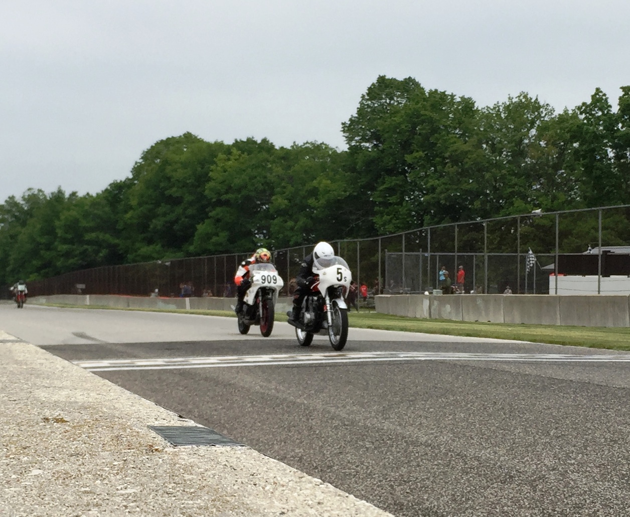

Road America is one of my favorite circuits.  You can really haul the mail on 3 different straights!  My competition was Mark Morrow and Ryan Hunt on RD400's set up like TZ's.  Was please to discover I had a little top end on both of them.  Unfortunately my front brake continues to be an issue.  Can't seem to make it work without fading badly.  Was gridded on the last row with a couple classes in front of Formula 500.  Got a great start Saturday and shot up the inside to take 2nd into turn one.  A lap or so later Morrow passed me and then Hunt to take first.  Finished in 3rd.  The weather was iffy on Sunday which thinned the field.  Got another good start Sunday and then it nearly went to #$%*, a racer in the middle of the grid had stalled his bike!  Rolled out of the throttle, dodged to the right, and then held 2nd place to the race finish.  Hunt was a DNS.
Have 3 weeks before Mid-Ohio to try and get the Suzuki GSX ignition working.  So far it is not cooperating.
A couple pictures from RA.
Trying to keep my pit crew in line!
Leading Mark Morrow's RD400 over start/finish at Road America.  Wish it was the last lap!

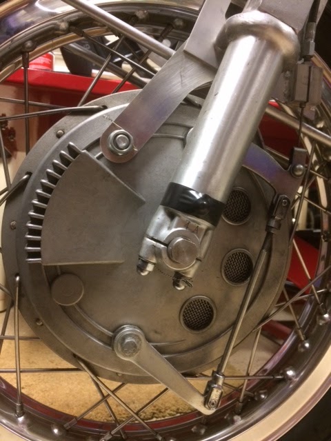

Good news about that front brake. Michael Morse is the man on all things "brake", glad he helped you save the front drum.

So now it is time for a post season tear down and inspection.  Have a couple small changes I want to make which will keep me occupied during the winter layoff.  Thanks to everyone who posts to this forum.  I check it daily and look forward to reading about everyone's builds and adventures.  Keep up the good work!
