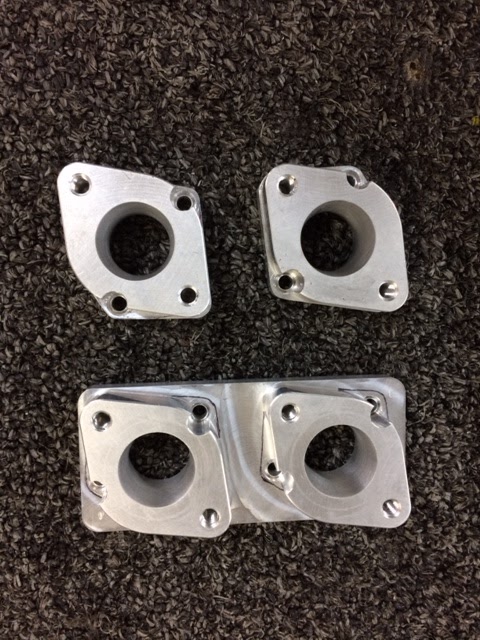

now that i see the manifolds installed, got to tell you that i am not excited about the way they block out the exit of hot air at the back of the head,
all that effort with exotic coatings to reduce thermal load and then this? :)
would cut off the plate around the inlet bore and two screws and leave each manifold alone.
thats the way i built mine, never had a problem with rigidity or sealing, weights a ton less and keeps air passage free
will post a pic later, not at home now

yes i must agree with tg , you have created an air dam . by the end of the back straight that head will be very very hot .

Relieve the back side, trim all you can off it and drill a bunch of big holes.

I had not considered the effect on air flowing through the head!  Will need to take a good look and determine the best way to open it up.  Good call TG!  Thanks.

The new and improved intake manifolds!
Before & after.
Now that's what I'm talking about.  Lots of airflow now!
It is good to have friends with machine tools.
Big thanks to TG for spotting the issue.

Wow!  Amazing how much area was uncovered.  Have you also port matched them to the carbs & head?

They have been port matched.  Some of Mike Rieck's handiwork while he was refurbishing the head.

They look really good.,well machined..
 Bet they match up easier as singles than 2 paired up..
