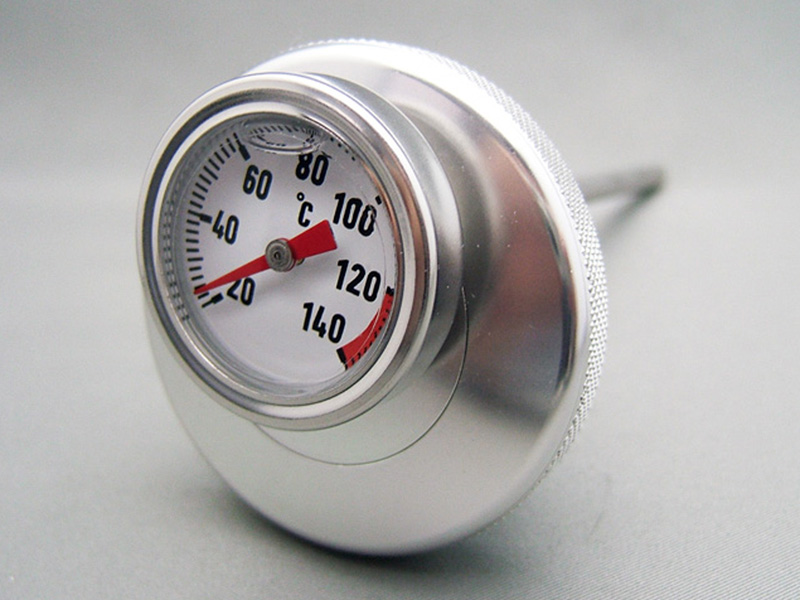

From what I've seen, None of the gauges come with the fitting necessary to put it into threads where the oil galley cap once screwed in. Is this correct?
Everything I'm reading says that I will have to take out the galley cap, then drill and tap it myself. I don't have a problem doing this, but if there's a simple plug and play solution, I'm all ears. If not, whose got the best write up on materials needed? Thanks!

Joker machine makes a plug and play solution.
The plug thread is M20x1.5 and there is an o-ring to seal - if you feel like making your own oil pressure gauge adapter.
But lot of people just tap the plug and call it a day, the oil gauge usually has 1/8" NPT thread.

I had my eye on that one! Was hoping there might be a cheaper, black alternative but if it saves time and is plug and play...ill take it, especially since I have no other way to diagnose.

I do, but I've decided to order the joker machine gauge, which should be here by Saturday. I'm also looking at an oil cap temperature gauge, but at the moment I can only find them in Celcius from Japan. If I can't find one in Farenheit I'll order it, but If anyone has a good source it would be appreciated. This is the only type I can find for a cb750 sohc:

So I can still have sufficient oil pressure according to the galley plug mounted oil pressure gauge, but not have sufficient amounts of oil getting to the valve tappets?
Could I have done something wrong when I changed the oil? Possibly not priming the bike properly? I'm new to this kind of setup.
Also, you guys are saying that oil should realllly be flying out of these open valve tappets? For instance, if I were to stick my hand an inch or two away from the opening I should be getting oil all over my hands?
Maybe I'll take another quick video during daylight...after I get that pressure gauge installed of course.
Thanks in advance for the help folks.

It's just that it is quite common for these oil jets to get plugged, and the results are catastrophic.  Low oil pressure is rarely a concern with the cb750 though...
....so what I do with a suspect 750 is loosen an exhaust valve tappet cover so it is just hangin on a thread or two, start the bike and run it for a minute or so to make sure full flow has reached the camshaft, remove cap to see how much oil splashes out, if you have to slam it back on to stop the splatter you know you are good, if you have time to peek into the hole and look around without getting a faceful you likely have problems.  Check both sides as there is two seperate oil feeds to the two cam towers.

Killer advice! That makes much more sense, because the video I posted of the open tappet covers was after only a very short period of running, and the covers were off before I started the bike.
Regardless, I don't expect my gauge to be in until Saturday so I'm going to wait to do any starting of the bike til then.
Thanks again.
