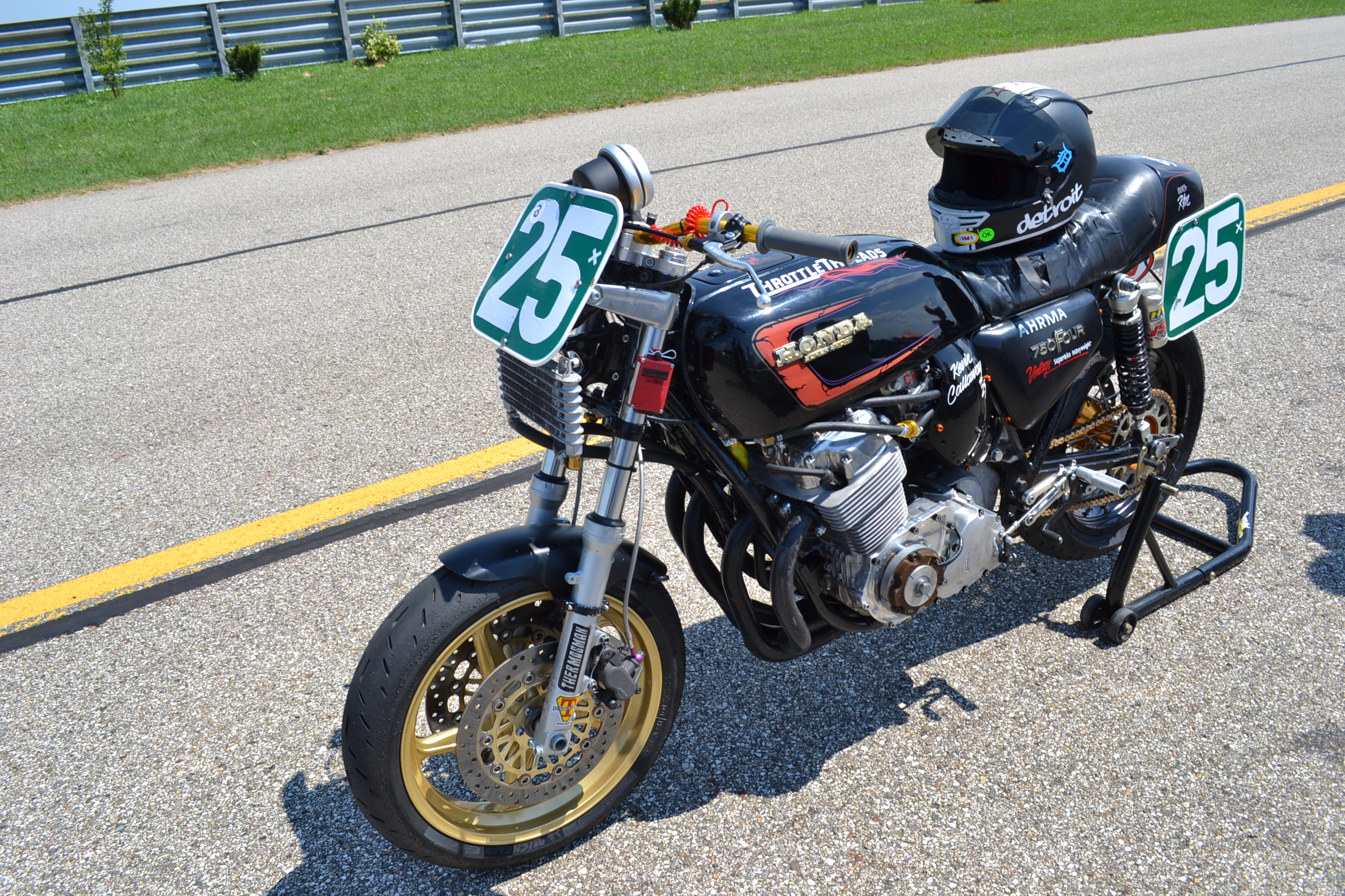

Hi there,
I weighted my bike just yesterday, 180 kg in full working condition (oil + fuel). I'm aiming to remove at least another 10 kg during the winter... let's see...

Livefast_dieold,
180kg(400lbs) is pretty impressive wet(or dry for that matter).  Curious, how much fuel are you counting here, 4 gallons?  Beautiful bike by the way... 8)
