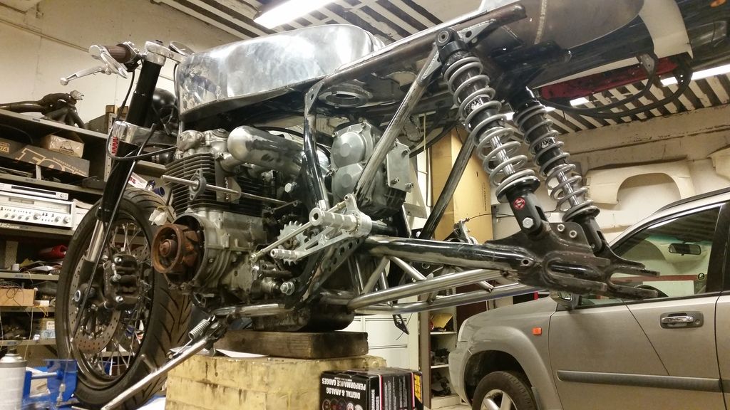

still working on it, finished some more frame bracing, made the rear brake wire pull, instead of a rod, and started rebuilding the engine. its getting there, but slowly :)

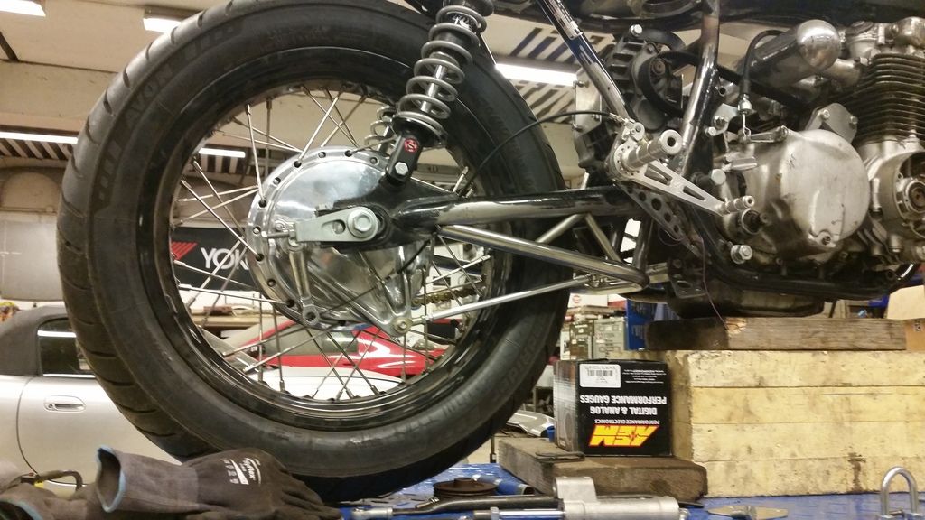

because of the potential extra horsepower in this supercharged engine i wanted to beef up the swingarm a bit..
The bracing has plenty of clearance to the chain, and the lines "flow" with the rest of the bike i think. lots of extra stiffnes, without having to install a more modern looking alu swingarm that would look out of place :)

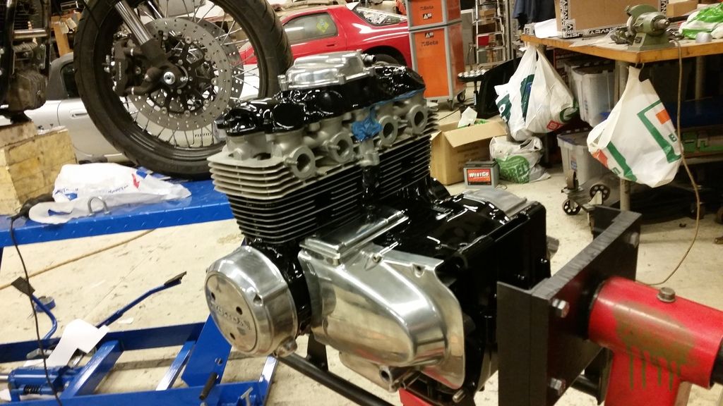

Also started on the finish for the engine.. black block and sylinders(with polished fins) all outside covers will be polished.
Waiting for a few more bits before i will finish assembly of the engine, and paint the frame and swingarm:)
Offline simon#42
  • Posts: 2,693
  • liverpool
Re: fuel injected supercharged resto mod cb550 track & street bike.
« Reply #37 on: October 09, 2016, 03:43:40 PM »
i think you are right about the arm , it looks good
