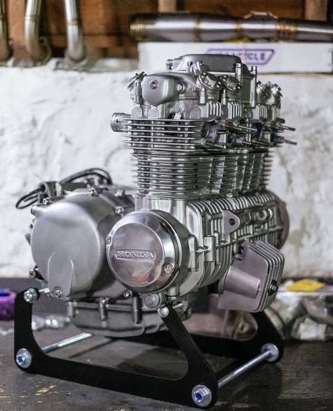

Motor is all done, and ready to rock. Need to put the bike together over the winter. I’ll start a build thread once I get going.
Offline Camrector
  • Posts: 579
Re: CB550 Motor Build
« Reply #90 on: September 27, 2018, 01:02:59 PM »
  • Posts: 12,569
« Reply #91 on: September 27, 2018, 10:40:20 PM »
Very nice Cam!  Pretty monochromatic but that is how they were out of the factory...  Do you have a concept of what the color scheme is going to be in the end?

I think this one is going to look like you ran the entire bike through Nils’s vapor blaster. ;D
