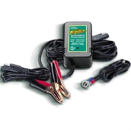

Another thing is that the bike won't charge it's battery very much (at all) at idle speeds, you really need to go drive it for at least 10 or 15 minutes in order to offset the drain from starting it (unless you are kick starting it  8) but even then at idle speeds you're draining the battery, not charging it).
Do you have a Battery Tender or equivalent trickle charger?

No charger but will get one pronto ....... thanks for the advice ,,,,,,,, I'r read somewhere that the old alternator's were marginal at low speeds .... Anybody can recommend a good brand of charger ?
I have one of these:
The "Junior" is pretty good too I hear:
Walmart sells them both, as does Amazon, and a bunch of local retailers.

I'll order one from Amazon tonight .... I read so many books, I'm a Prime member.
