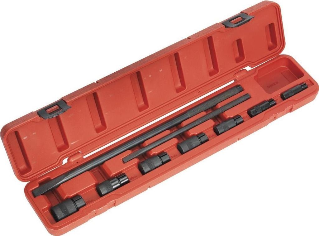

Yeah, after a couple of false starts I bought a fantastic wheel bearing puller a couple of years ago Scott, it removes the old bearings in only a minute or two, with no damage, I only wish they were available 30 years ago!
I bought a pair of Yamaha FZ6R wheels to install in my old FJ1200, but after I spent ages removing the 17mm ID front wheel bearing and replacing it with 15mm ID bearings to suit the FJ axle I changed my mind. I'm now thinking that they'd look good on my Honda VTR1000 streetfighter project, which will entail removing/replacing the wheel bearings all over again, but the tool makes the bearing removal job so easy, it won't be an issue.
If you haven't got one of these kits, buy one mate, it's definitely worth the investment! Cheers, Terry. ;D
