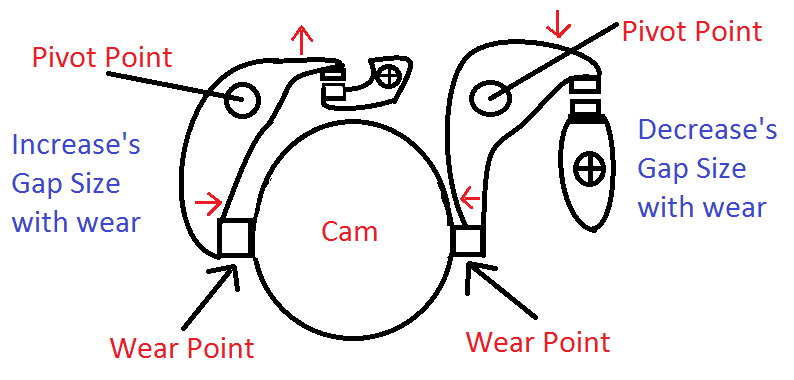

I made a drawing in paint for the understanding for gap wear and yes 0.16 is the way you want to set it up.
« Last Edit: April 07, 2016, 05:27:32 PM by Darkdragono »

Gotcha, I thought Jonda was talking about uneven wear of the surface due to misalignment, not the surface that meets the cam.

« Reply #16 on: April 07, 2016, 11:58:21 PM »
Gotcha
I don't understand  the drawing. Left breakerpoint is not shown as it sits in reality so...

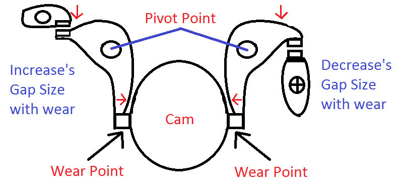

Gotcha
Well my point with the drawing was not to be identical on each side so to show that the setup would have to be completely different to increase the point gap with wear.
so here's another drawing with sides that look the same but notice the contact point has to be at the top in order to increase the points gap over time with wear.

« Reply #19 on: April 08, 2016, 04:59:51 AM »
I'm sorry but the drawing still doesn't represent real live. You've got the 1+4 points depicted wrongly. Gap decreases over time on both set of points. Anyway start with opening of 0,4 mm and you'll have reserve.

« Reply #20 on: April 08, 2016, 06:33:30 AM »
He's not trying to show how points work. Above it was said that the points decrease over time then other members refuted saying that it would increase over time. He just drew it up showing if it was to decrease or increase over time how it would have to be positioned.

« Reply #22 on: April 08, 2016, 07:21:43 AM »
Pardon me, I know what it was about. It was about whether the pointsgap increases or decreases when the fiber part wears. Well, as well for 1+4 as for 2+3 breakerpoints gap decreases. In his picture he puts it's increase for the one set and decrease for the other. That's just not correct.
