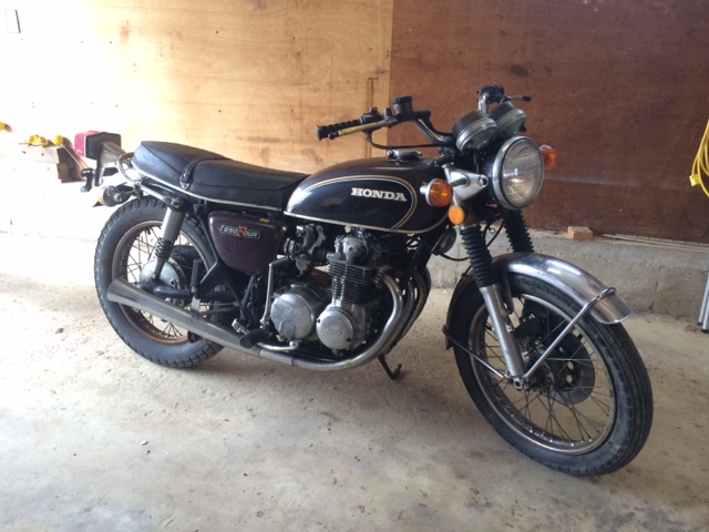

Hello.  I am a vintage bicycle mechanic for a living but I decided to build a cafe racer.  I bought a 1974 CB550, can't remember if it's a "K" or "F", pretty sure it's a "F."  Boss maroon metallic.  It's pretty much all there.  I have the original air box, tool kit, rear light, etc.  It's in pretty rough shape, been sitting for possibly 30 years.  It was in a garage, but it must have been a pretty leaky garage because the rims are rusted on one side.  I checked the frame pretty closely before I took it home, frame seems ok, most of the rest of the bike has little rust on it at all.  The rims don't even really bother me because its just surface rust and in NJ where I'm going to register it there is no inspection.  I know how to build wheels so I can switch the rims any time.
The bike needs to be re-wired, at some point it had a fairing on it but its been removed and the turn signals were incorrectly re-wired.  The engine moves, no idea if compression is good, all four plugs get good spark.   the front brake was completely seized, i need to rebuild the front lever and the caliper.  The tank has a minor amount of rust in it and the petcock valve doesn't close properly.  Carb 3 looks burned out, probably the reason the bike stopped being run.
My end goal is a cafe racer but first I need to get it running.  I live in NYC and would like to find a place i can store it while I work on it like Vax Moto or Roll Up Brooklyn.  I'd like to find a place that has a mechanic that knows how to build cafe racers.  There use to be a place called "Wrench'n'Ride" in Bushwick where you could store your bike and they would teach you how to work on your bike but they are no longer there.
If that type of place doesn't exist I'm ok with just giving it to a mechanic to get it running and then doing all the bolt-on stuff myself.  Who's a good Honda mechanic in NYC, Long Island, or Jersey?

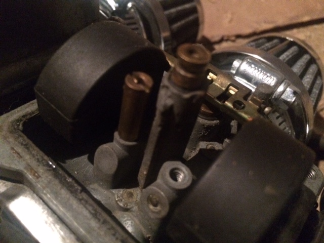

Thank you all for the advice and warm welcome.  I bought the bike on eBay from a seller in western PA for $1,380 USD.    I drove through 12 hours of fog to get it.  He had already rebuilt the carb (notice the new float in the picture), but claimed he stopped because when he was rebuilding the carb he lost one of the clips but had found the clip before the auction ended.  I think what really happened is he rebuilt the carb, discovered carb 3 was leaking because carb body 3 is so corroded that it doesn't form a good seal around the o-ring on the main jet (see same picture above).  What could have caused this?  This doesn't bother me that much because a new carb body #3 is only $50.  He said when he got the bike the engine didn't move but he put a few drops of oil in the cylinders then let it soak in and then the pistons moved.  Like i said before I need to rebuild the front brake caliper and lever too.  I forgot to mention it has very low miles for it's age, I think only 8,000 miles.  The tank has no dents and the paint is still good.

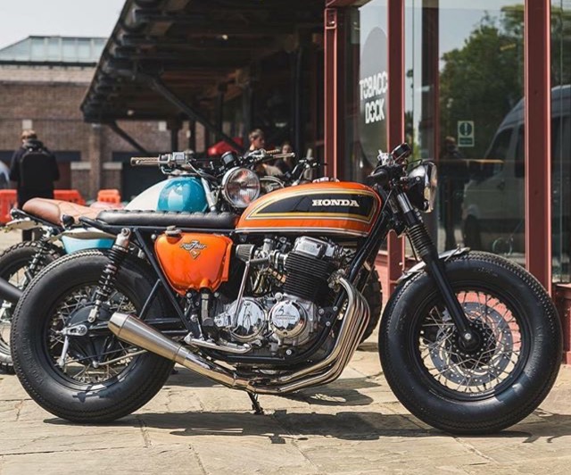

I've since learned that what I want to build is called a brat cafe, not a cafe racer.  Clip-on bars, fat tires, minimal rear lights, and a custom flat seat that's a little thicker than you're average brat seat; somewhere between a brat seat and the stock seat.  I'm going to keep the side covers on, I want to eventually run pods because I want to build a custom storage box under the seat.
What mods would you guys do to make a tough brat cafe to bang around NYC with and do a few 3 hour upstate runs with?  I want to get ideas from you guys before I start my build thread.  Rev limiter?  Wire mesh over the headlight?  big bore kit?

I wouldn't go as extreme on the fatness of the tires in that picture, and also not nearly as thin on the seat padding either.  I'm very short so naturally I'm already going to be very far forward with the clip ons, I'll basically just be hugging the tank.  My short torso will put the pegs more back relative to my seating position from my torso being drug forward by the clip ons.  I kinda need the lower seat and lower bars simply from being "inseam challenged".   I'm probably going to end up lowering the bike a smudge too.  The aggressive position is actually something I want, I'm use to the aggressive geometry of my bicycles where the saddle is actualy higher than the bars.  My body is use to this position.

Others have offered good advice so far. Big tires, even tires that are simply bigger than recommended but will fit on the rims, reduce the handling capability of your bike. They're a bad idea, unless you want to go slow around the corners. I'm not a fan of the whole "brat" thing, and "brat café" is another amalgamation that someone simply made up. When people build "brat" seats, they frequently just put a flat seat pan on the frame rails (usually after chopping off the support between them). On the CB550, this support sticks up a little, so when you put a flat seat on it the rear tire rubs on the underside of the seat as the shocks compress (exacerbated by those big tires). This is very dangerous. And of course you lose the stiffness that the support provided for the rear end of the bike. The advice you've received about clip-ons is correct too -- ergonomically, you're going to need rear sets. Running the smallest possible tail light also reduces your visibility to drivers behind you, something to think about.
These changes aren't just a matter of aesthetics, they are a matter of function (and safety). Ultimately, it's your bike, but seabarney's advice is spot on -- run a stock bike for a while so you know what it feels like, then make some decisions. If you do all the things you're proposing, you may be permanently altering your bike in a way that you'll regret when you realize just how badly it performs. Again, it's your bike, do what you want, but while some people may think bikes like that 750 look cool, anyone who knows anything about bikes realizes what a shame it is to do that to such a cool bike.
