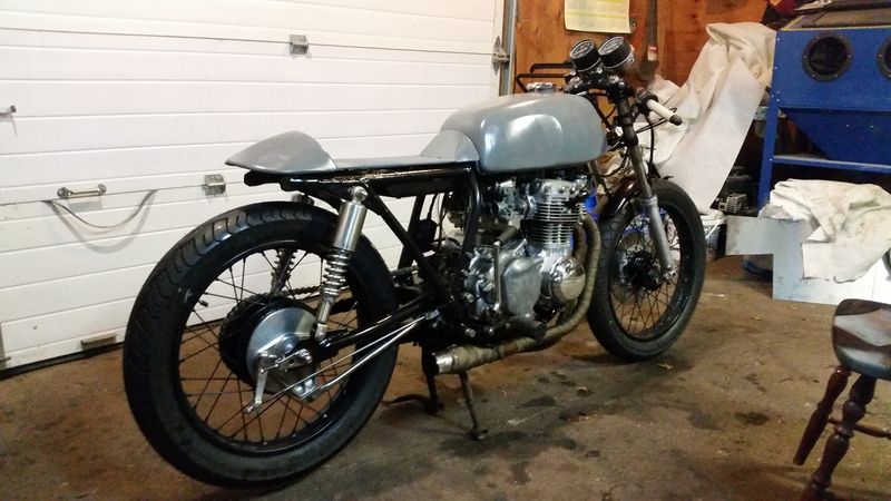

Long time lurker here but ill start by introducing myself. Name is Mark! Gotta say this forum has been worth its weight in gold for all 3 CB's i've owned. Currently im working on a CB 350 F, has about roughly 35 thousand miles.
Did a compression check on it and had pretty well 65 psi right across ( pretty sad ) but felt optimistic and thought hey, maybe from sitting for 2 decades the rings are just stuck. Got it running the other day and it ran well but sure enough its burning oil. Still feeling optimistic and threw some engine restore into the engine and it did work (shot to about 90 across) but still not good enough to get the rest of the season out of.
Anyway. I bought new pistons and rings. Obviously the heads will be off but just curious on when the timing chains get changed on these bikes? Or anything else that i should consider during that time.
Heres what the bike looked like a few days ago!
