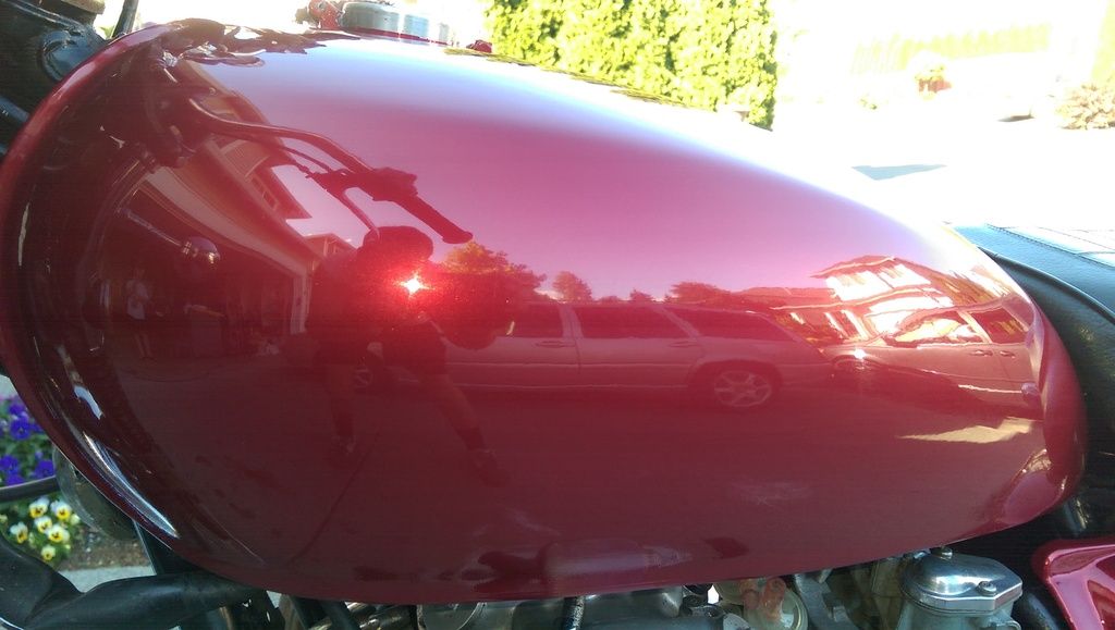

With spray bombs, be sure to use Spraymax 2k Clear over it.  I applied clear 12 hours later.
Great fuel resistance.  One can will do a tank and covers.
I did 6 coats of clear on my 550 tank (left a big overlap at the filler hole) and 3 coats on the covers.
I wet sanded from 1000, 1500, 2000, 2500, 3000....
This is the tank after fine cut cleaner.  Still needs to be polished.
