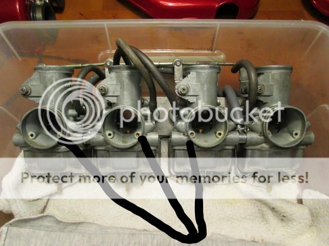

« Reply #7 on: September 07, 2016, 06:12:55 AM »
It kinda kooks like you gentlemen are correct, but I need to do a few more tests on the carbs.  The air jets on #1 and #2 are somewhat clogged whereas #3 and #4 are WFO.  It seems to be that these air jets are pressed in and I am out of my league here as to how to fix.  Any ideas anybody?  Thanks to all in advance.
JohnD
1982 CBX; 1982 CB1100RC; 1983 CB1100F; 1969 CB750
Re: Exhaust pipe question
« Reply #8 on: September 07, 2016, 06:57:47 AM »
Spray carb cleaner and a brass wire.
Ultrasonic cleaner
Carb dip
...or some combination of all three  ;D

« Reply #9 on: September 07, 2016, 07:02:01 AM »
You can pick up a high E guitar string to use to clean out the jets combined with carb cleaner.
