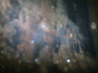

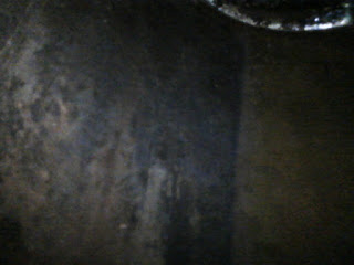

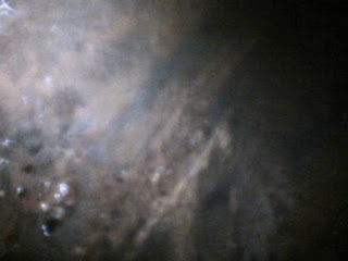

The cylinders, well at least the ones that the spark plugs came out of look like a cast iron sewer pipe.

Not as bad as I expected.
Pretty stained but they don't seem to be pitted. They don't feel different to the touch.

I'd say take it down and soak all combustion chamber parts and scrub them out.  Posible hone befor doing rings
