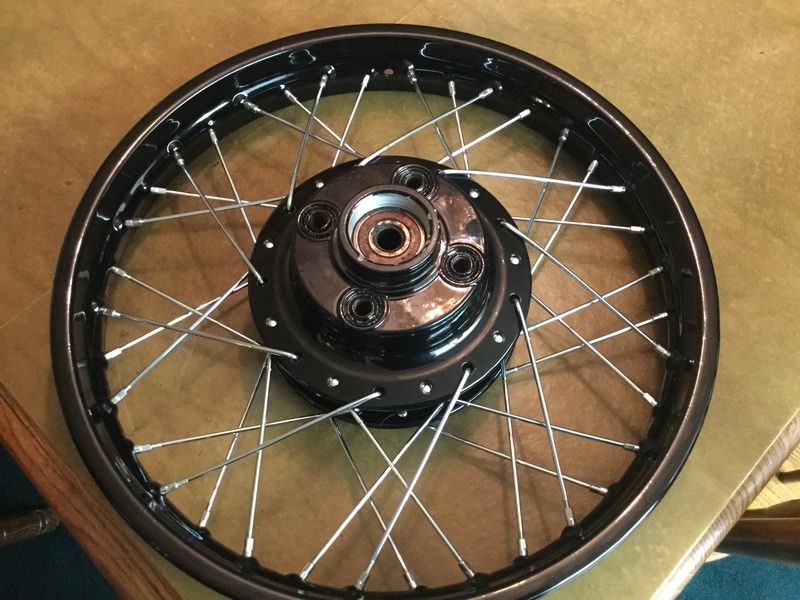

For both myself and her, bout October through the end of the year is the busiest time for our jobs.  Add in the Hollidays and it becomes a disaster!!
However we did make a slight bit of progress.  Got a wheel laced up and looking relatively pretty.  Just need to find some time to go pick up a stand and try my hand at trueing the wheel.
From everything i can see and read, i've got it done right.  She's got a spare wheel so it was pretty easy to copy it.
