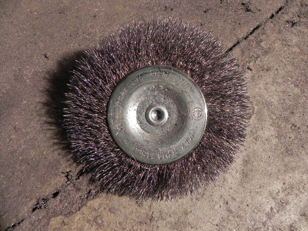

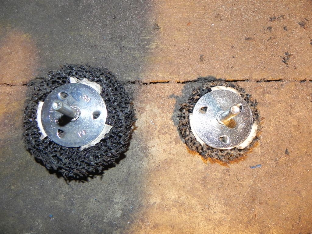

Spent maybe 4 hours on this, using a mix of the rattlecan stripper and a steel wire drill bit. Once over got the dark blue paint off, then got the light  blue paint off the headset and a couple of other bits. The brown undercoat is primer from a loooong time ago, and is stuck fast. Even though I've got most of the paint off, I'm going to invest in some paint-on stripper like you guys advised. I thought I could get by with the spray on stuff because of how easily the dark blue top paint came off, but all that really shows is how cheap that dark blue topcoat was.

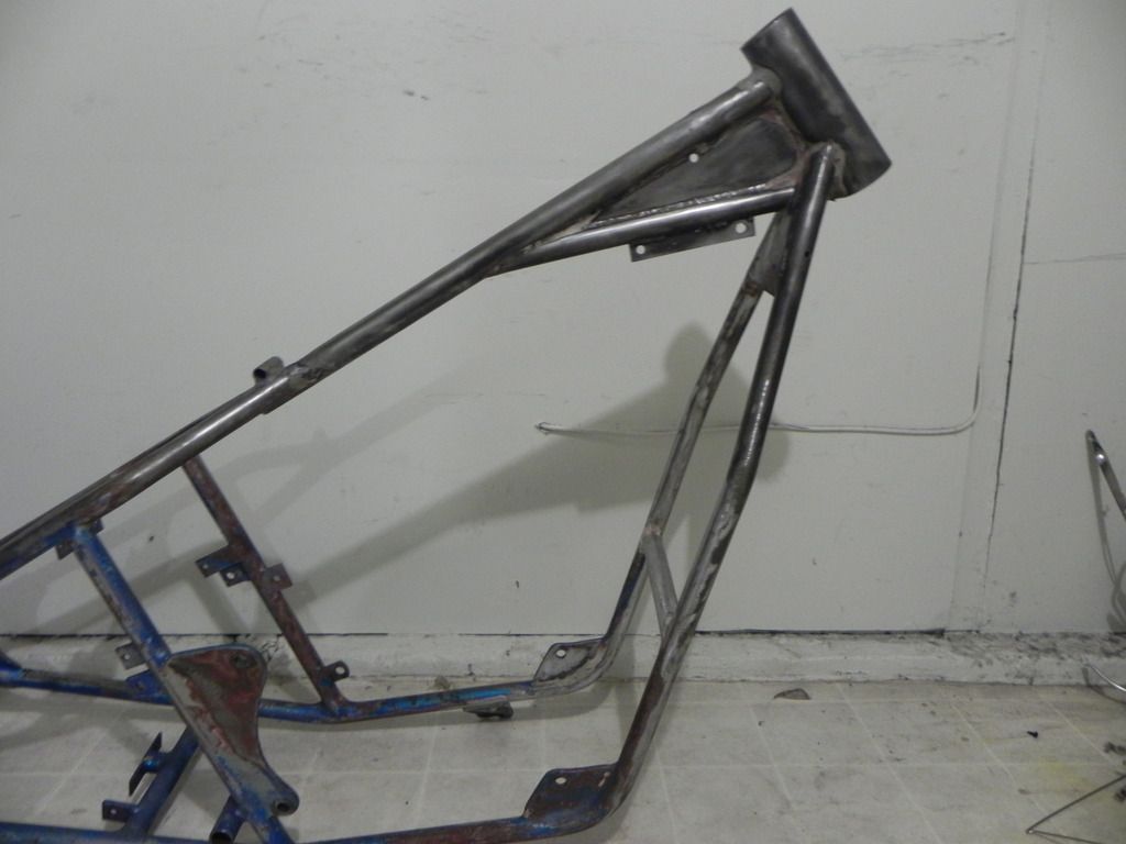

This photo was taken in the basement of the sharehouse I'm in, as I know these frames (when stripped) love to develop surface rust. I'll pick up some paint-on stripper after work tomorrow and keep you guys updated  8)

It sure is, but geez, it's agricultural. Looking at the welded on brackets (which I presume were done by Amen) I can't help but think they didn't put a lot of effort in chamfering the corners at all, it looks like they've just gotten a piece of flat bar, drilled a hole in it and welded it straight on. Maybe Anglo could take a file or a grinder to them before he repaints it? Just a small detail I know, but the overall finished bike will look better if those little details are attended to. Cheers, Terry. ;D
Yeah fair enough.  Depends how pretty he wants the build eh.  A little finger skim of bondo and a touch of sanding could clean them up quite easily as well.

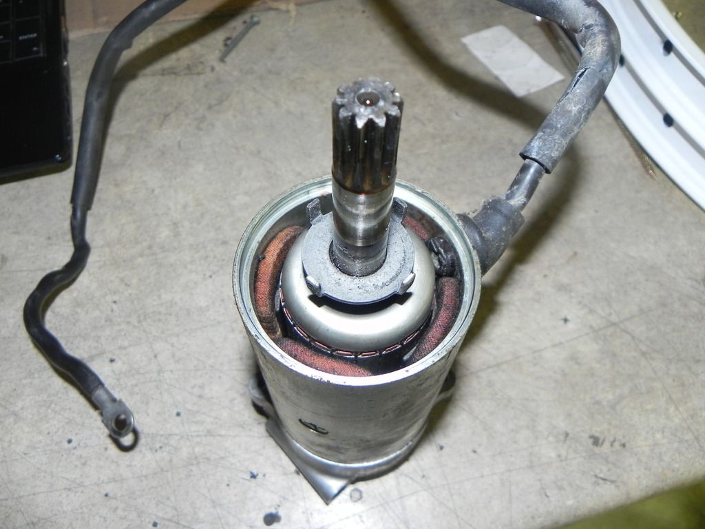

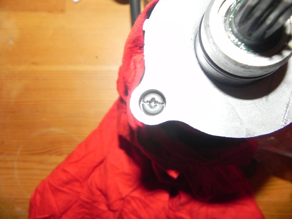

Decided I was sick of working in the sub zero garage for tonight, so I pulled the starter motors from both the spare engines. The previous owner re-wired all the switches into the space where the starter motor sits, but I'm planning on putting most of the switches back on to the bars and re-installing one of the spare starters. Kickstarts are cool but when on a tour I can imagine there will come a day where cool becomes irritating... It'll still be there to impress geezers from time to time  ;D
2 starters! My cup runneth over. So I get my impact driver on the first motor and-
Bugger. Okay well I'll be a little more careful on the next-
Well.

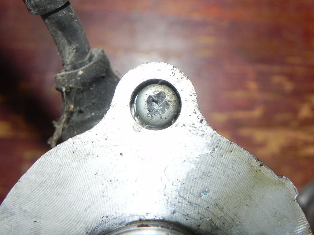

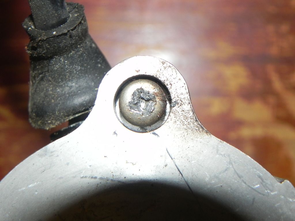

Whoopdedoo  ;D Well 5 minutes of work and two rounded bolts later I'm ready to pack up for the evening. Once you guys are done chuckling at my ineptitude, any hints on getting these bolts out? They're torqued down tight. Updates on the frame tomorrow

Yep, JIS tips for the impact that fit the bolts properly..

Japanese Industry Standard impact driver heads is now on the list. How can I get these cheesed bolts out in the meantime?

I don't even think you'd need to drill it out.  Just grab those screw shafts with vice grips or something similar and turn them.  having the head of the screw still on will give you some leverage as the bolt won't want to bend as you unscrew it like it would if the end cap was removed first.

Then take a hacksaw and cut screwdriver slots in them..after you get em out..

You can try tapping on the head with a and using an offset #3 before drilling the head.

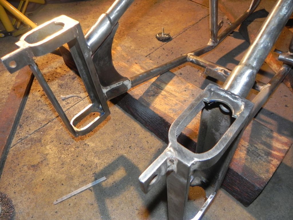

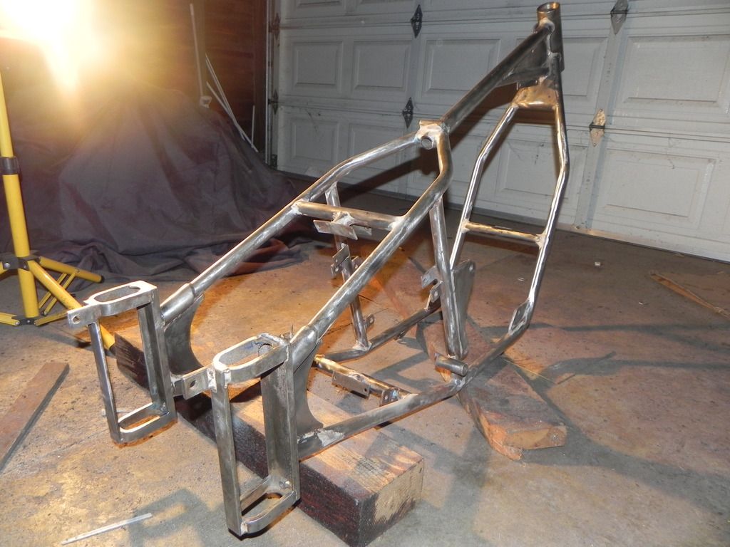

Anyhoo good news on the frame strip, its pretty much done!
And before you start circling bits of remaining paint I know they're there, I'll be going over the whole frame with some fine sand paper before I put the primer on, so I'll get to the fiddlier fiddlyer More fiddly bits then.
Pretty pleased with the spring mounts.

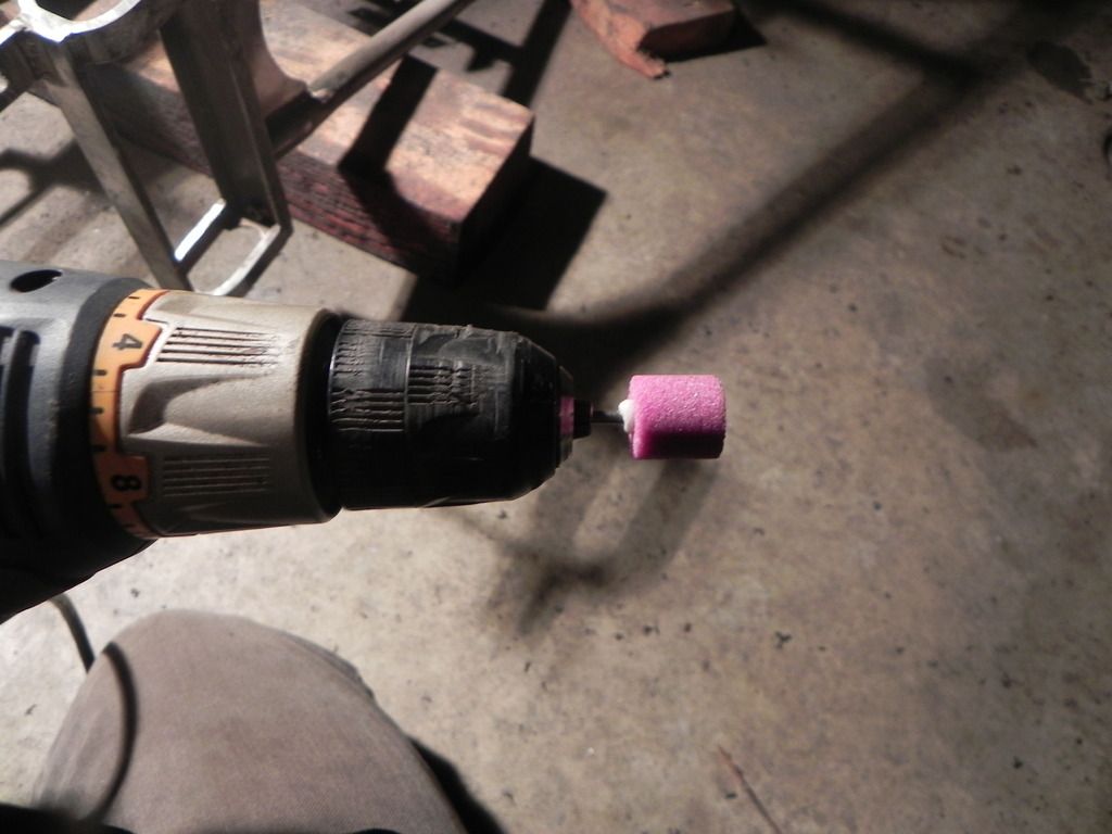

This is about 8 hours of work with a 2000rpm corded drill and a handful of basic attachments, such as the 'rust removal grinder'. Both of which have been worn almost to the nub
And the 'Brass' wire brush  ;D which is now completely cheesed!
In terms of sanding down the harsh edges on the frame, I got a sanding piece but...
Its... A little ineffective ;D I'll pinch a file from work tomorrow. I know you guys don't really like spray on things, but I picked up some spray on self etching primer on the advice of a friend.
I'll be using the sandpaper and file tomorrow night, then I'll prime up the frame and move on to the perilous world of paint selection  8)

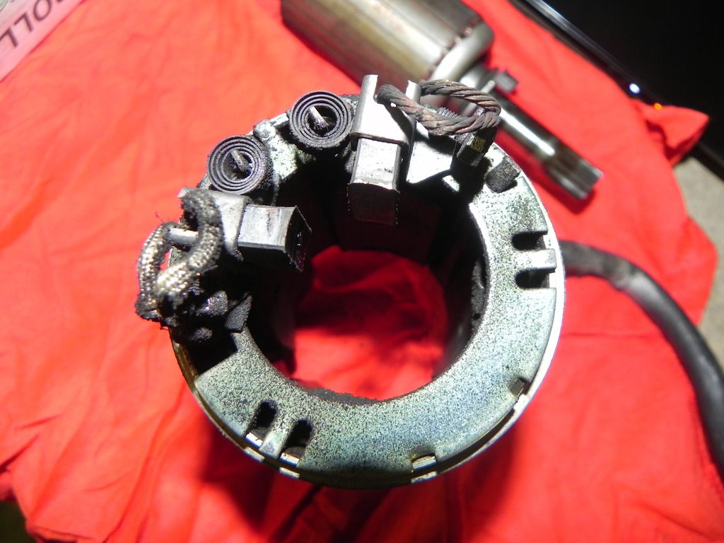

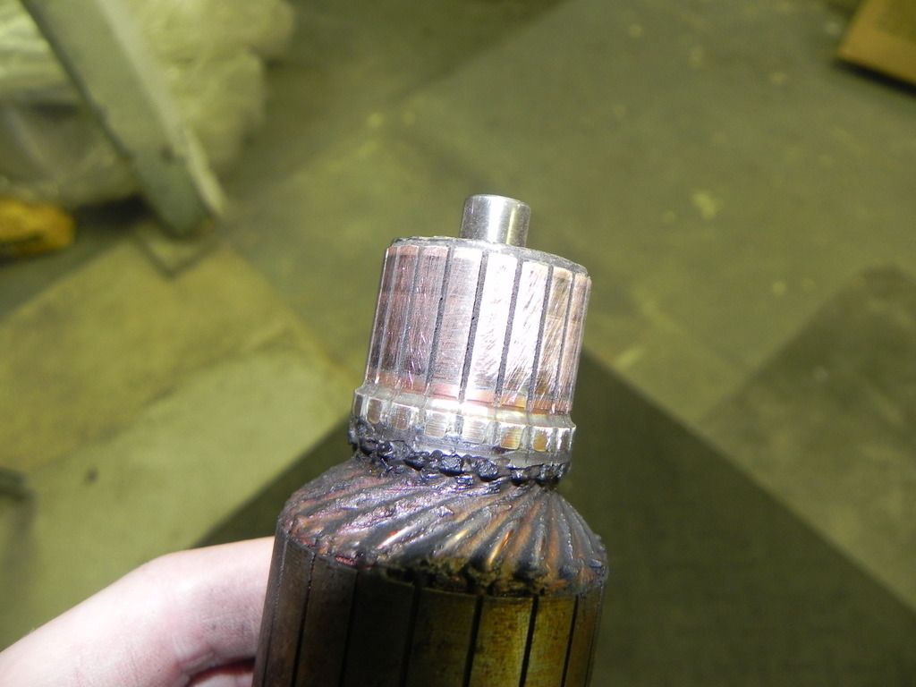

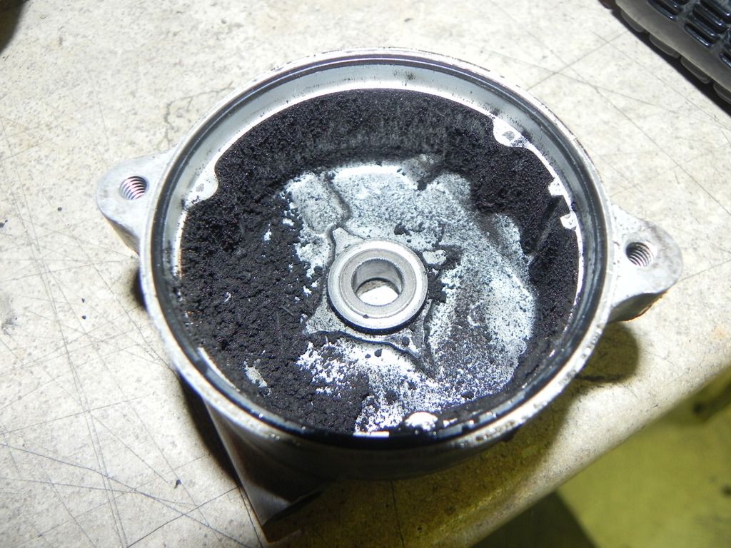

Bonus update on the Starter- Very good news! I took them both in to work so I could use the clamps and tools we have (I work in a bicycle repair shop) and it turns out one of the mechanics there used to be a car mechanic back in Albania  :o  ;D He had the bolts out in minutes!
All looking fairly kosher. Fair bit of soot in the bottom, but I'm lead to believe thats fairly common.
Blasted the lot with compressed air and tickled the springs with some contact cleaner. Almost looks new!
Sanded down the Brushes and the contact points. Didn't have the battery with me at work, but I can test it later. It all looks in very good nick.
And put the lot back together, not before sawing the screw head as 754 reccomended  ;D Saving the day one recommendation at the time.
