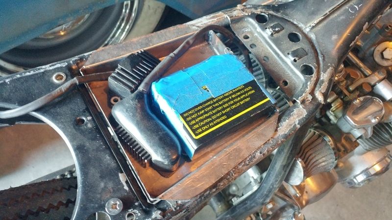

Started on a small electronics tray to hold the vitals. Still need to add the mounting hardware and some tie-downs:
