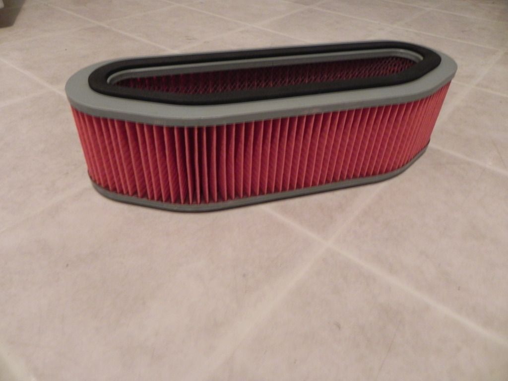

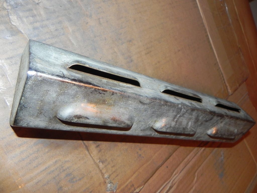

So like I said, I've not been sitting about doing nothing. I got an Air filter off a salvage shop in Tennessee at a pretty good price. I'm dead happy with it, I really didn't want to put pods on it.This is how it looked when it arrived
Got potential... I didn't take a picture, but the inside has light rust throughout, with a bad patch in one corner, which I can only assume must've been full of water at some point in its life. Sanded down the innards with a wire brush, its all looking good. As for the outside, I figured the best+ cheapest option was:

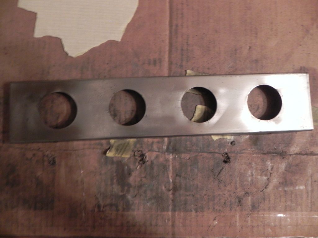

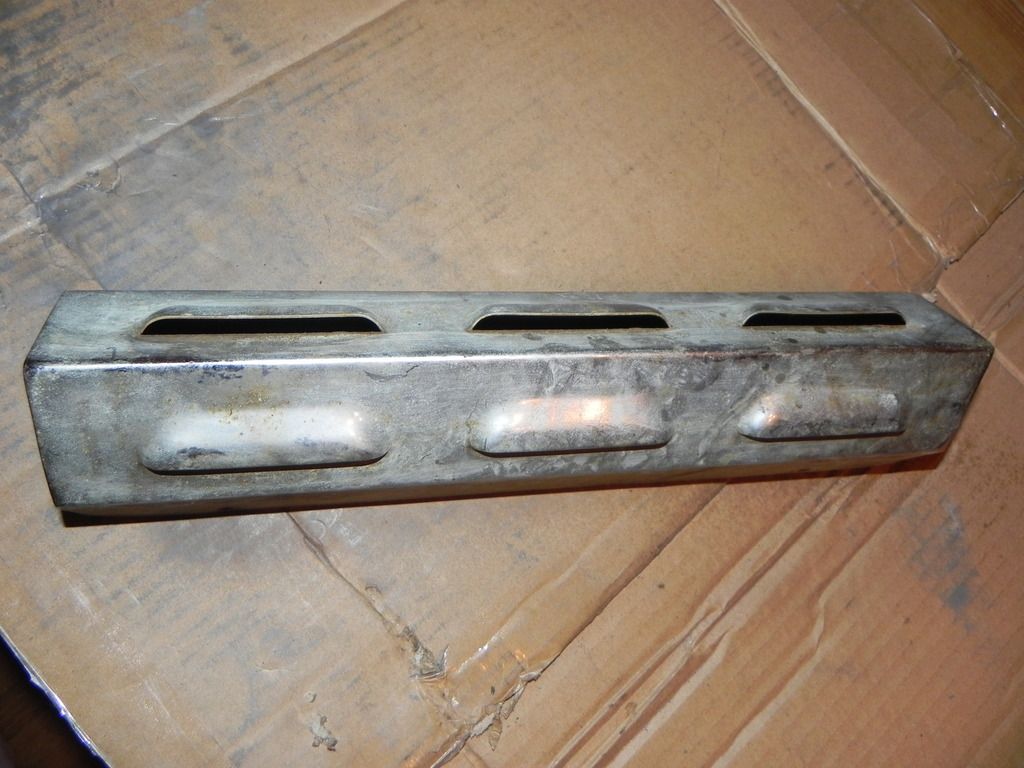

Elbow grease  8
Squirt of WD 40 to get the gunk off, then grit 400 to get the pitting off. Halfway across the back plate, already looking better
Whole way across with the grit 400, then over again with grit 600
Same again on the rest of the filter. this is after the 400 grit,before the 600. You can really tell when I didn't go in the same direction,but hey this was my first time

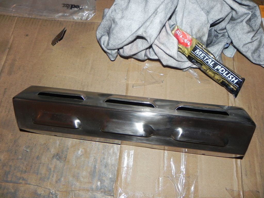

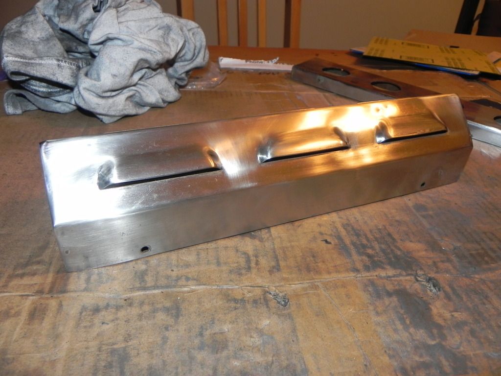

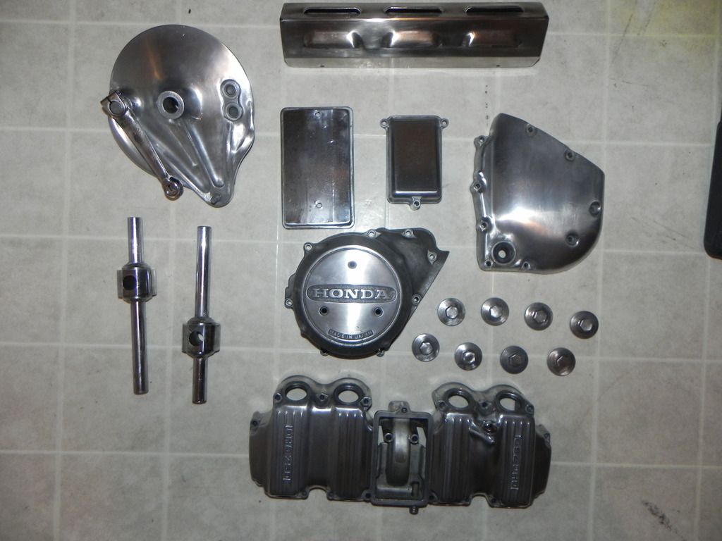

And then the finishing piece... Autosol.It doesn't look factory perfect... but I'm not entering a show here ;D If anything I've just been doing this to not let myself feel like I've lost momentum on the project, which is hard when you've hit a financial barrier.
'So thats one nights work' you say 'what've you been doing the rest of the time?'

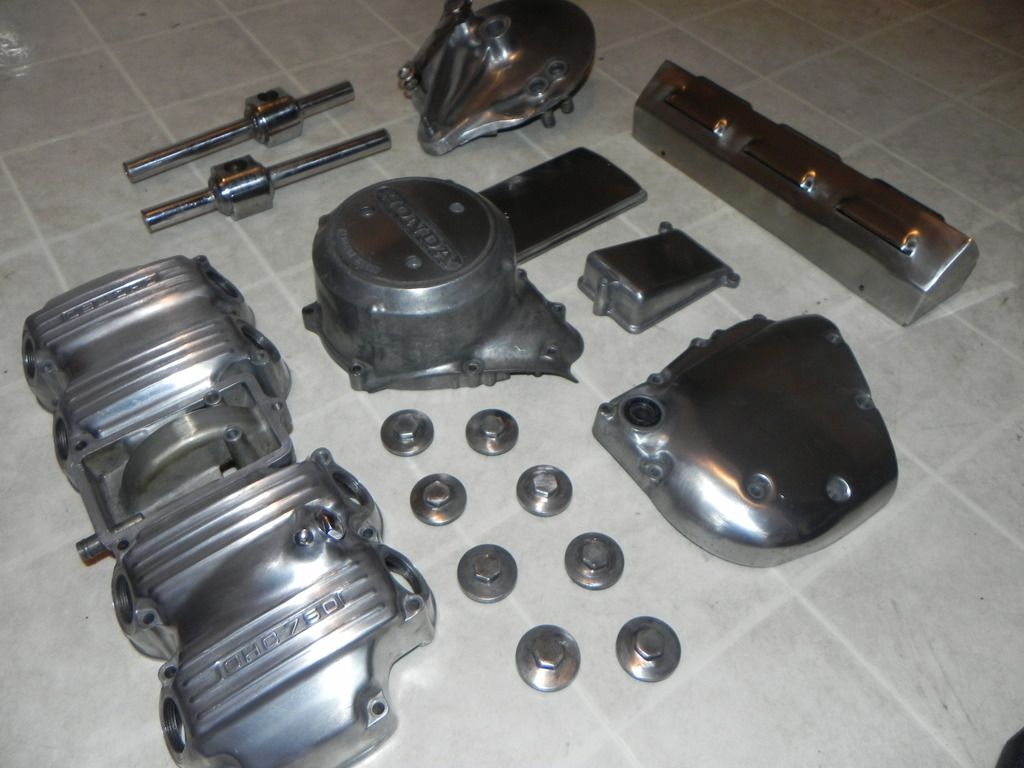

Well, I seem to have quite a knack for doing this. Its almost fun to just zone out, sit with the radio on on your workbench and sand away. To that end...
Yeah its not professional grade, but these pieces look so much nicer than they did.Especially the rear drum component, which was painted with thick black paint. I assumed it was to cover a gouge in it or something, its in very good condition underneath!

Parts still tickling in.

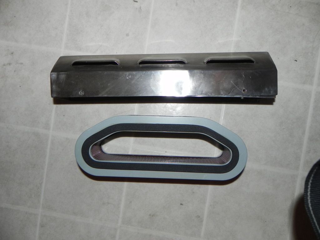

Air Filter Arrived amongst an oil filter and some fork seals
Which led to the embarrassing realisation that I've got a custom airbox that a stock filter isn't going to fit
I guess I got giddy ordering parts and didn't think to stop and check the dimensions!  ;D

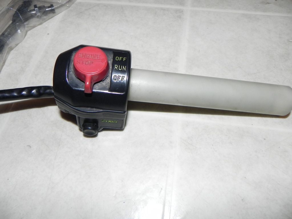

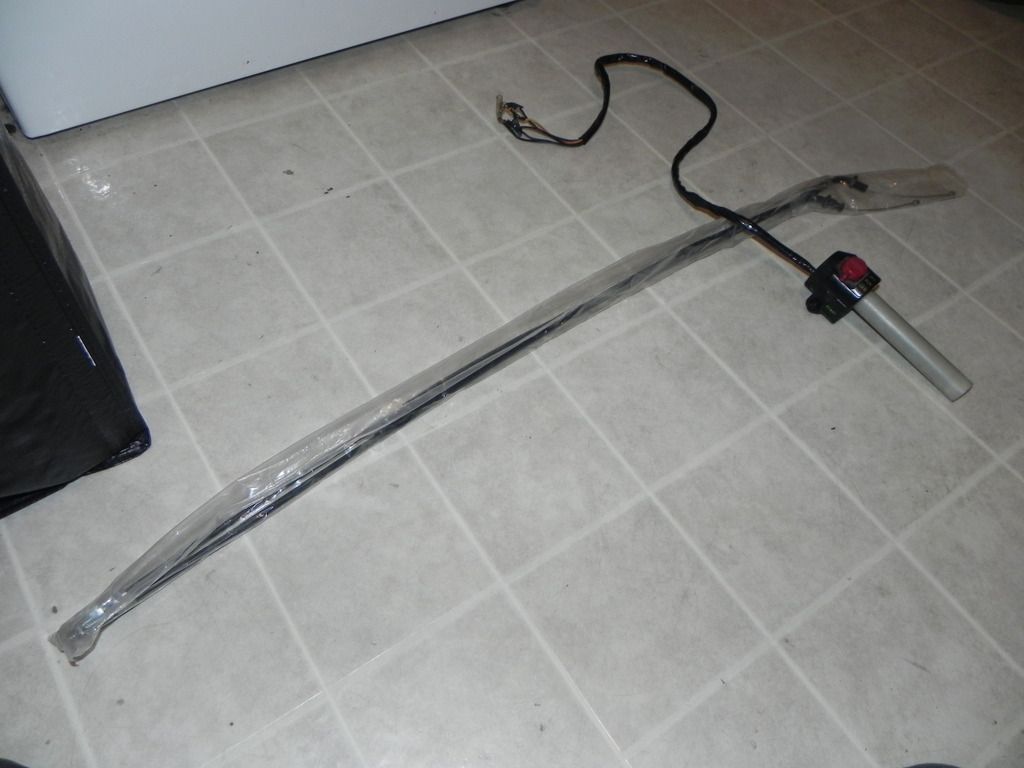

Got some new 10" over push-pull throttle cables from China as well, alongside my new 1978 cb750F Throttle body with handlebar controls from Iowa
I usually get mixed responses when I tell people I'm putting full handlebar controls on a chop... Honestly, I want to put a lot of miles on this thing, and to me at least it makes sense to keep as much of the controls and switches as I can figure out how to wire in. Might spoil it for some, but its just my preference  ;D
