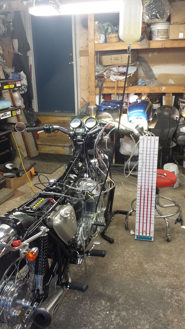

here is my low cost solution to carb balancing mine is a little fancier than it has to be but it works very well. Its got a 4 port air manifold with nipples at the bottom then 4 lengths of hose near the carb end there is a 0.030" welding tip in the lines for dampening. Filled with regular dextron ATF. I have used it quite a few times with no issues it is fast reacting and very accurate.
Maybe you can help me out with this; I built one of these with ATF and mig welding tips tapped to m5*.8 to act as the adapter and restrictor and have been able to hook it up but can't seem to get them all level. 1&2 are similar and 3&4 are similar but I can't seem to get all of them together on a similar plane.
Have any tips on how to adjust once running? I.e. 1&2 are pulling harder so loosen/tighten air idle screw etc. I can't seem to find a dummies guide that spells it out for me.
Re: recommendation on carb sync tool
« Reply #40 on: April 10, 2017, 08:21:14 PM »
 The actual synch is done with the large nut at the top of the carbs that sit under the rubber boots if you still have them and they raise and lower the slides if that is what your asking ?
Syncing carbs is essentially the same idea on all of the SOHC fours with some minor variations in how it's done. Some later bikes require taking off the top of the carbs. Some early bikes were done at where the cable goes in to the carb tops (early CB750s with one cable that splits into four, e.g.). Some later bikes with accelerator pumps are supposed to match to the #2 carb.  Which bike and year are you running?
I found it easy to adjust 1 to 2 and 4 to 3. Then 3 to 2 and 1 to 2 amd 4 to 3 until you get where you need to be.
That worked for me. Just remember adjusting one will affect another.
Sent from my SM-G930T using Tapatalk
