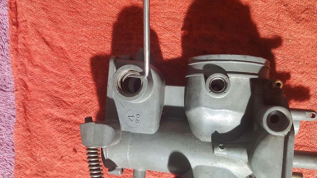

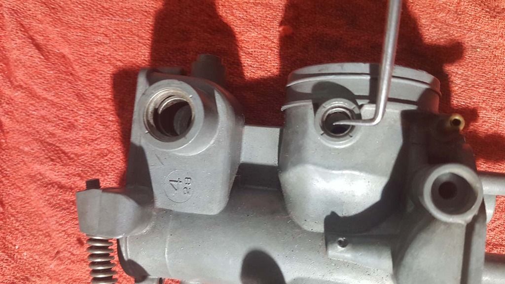

Hello,
Reassembling the carburetors for my 1977 CB750 F2.  It appears there is a seal missing from the throttle shaft where it enters the body.  The felt seal for the throttle valve shaft is also missing.   Please see the attached photos with the dental pick pointing to the location. On the two inboard carburetors, the seals are present.  I can't find part numbers for these on any of the exploded views or replacements on line.  Could anyone advise me on a part number / source?

@ Airborne 82nd.
I see the pictures were missing, attachments are waiting for approval so I'll insert them in this message.
Above:  Location of the felt throttle valve shaft seal.
Above: Location of the throttle shaft square cross section rubber seal ring.
