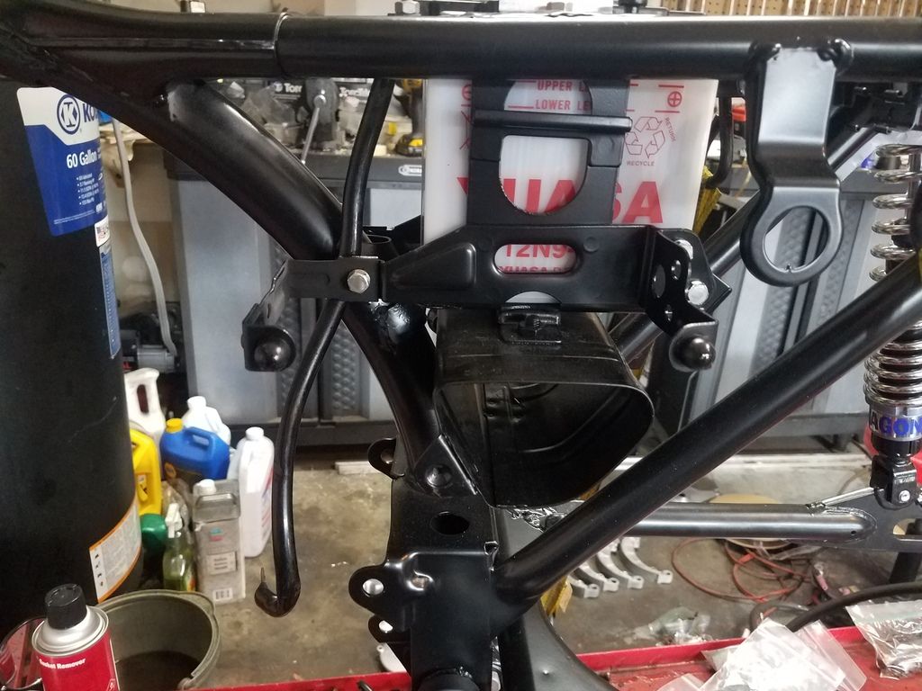

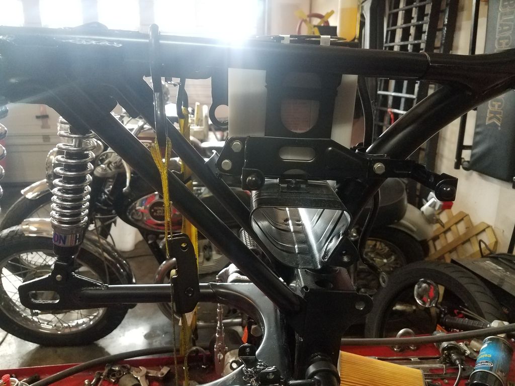

The shock mount bushings in the swingarm got deformed during the powder coating,  so I ordered some new ones to replace them. I am trying and failing to get the old ones out. does anyone who has done this have any tips? Am I going to need a press?
Thanks
Offline Jeffro93
  • Posts: 95
Re: 64 cb77 resto-mod
« Reply #27 on: May 18, 2017, 05:57:31 AM »
Thanks
It's a pain without a press, but so is taking it to a shop to get the work done.  I had the same problem -post powder coating - on my CB550.  I have repressed some of the details, but I essentially destroyed the bushing in situ, which left the outer "band" of the bushing still in the swing arm. I then cut through the band with a hack saw blade, which allowed me to deform the band and remove it with pliers.
I think I broke out the center of the bushing with a hammer and appropriately sized socket.

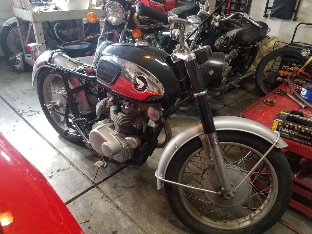

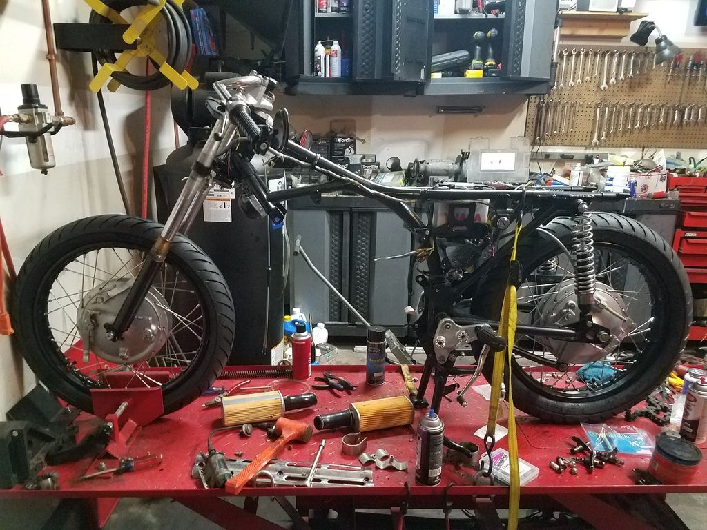

Those bushing really were a pain, but I got it done relatively quickly once I settled on a strategy. I first used a 1/2 inch drill bit to work out the inner part. After a few seconds on drilling it got hot enough to break away from the rubber and pop out. Then I stepped up to a bigger bit to drill away the rubber. Then a bigger bit to drill out the outer part. That basically just made it a little thinner so I could bend it easily and pull it out. The new ones went in without too much of a fight. I wanted to get the swingarm in, but my order what I thought was a pair of dust covers turned out to be a single so I had to order another.
My front fender finally came in from Thailand so I got that modified and now I can send everything off for paint.
I can't help but place the parts on and get an idea of what it'll look like. If course I couldn't get the lower forks to stay in the right spot, but you get the idea. I'm really liking this front fender.

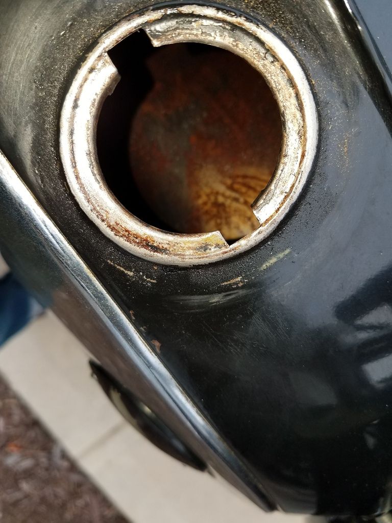

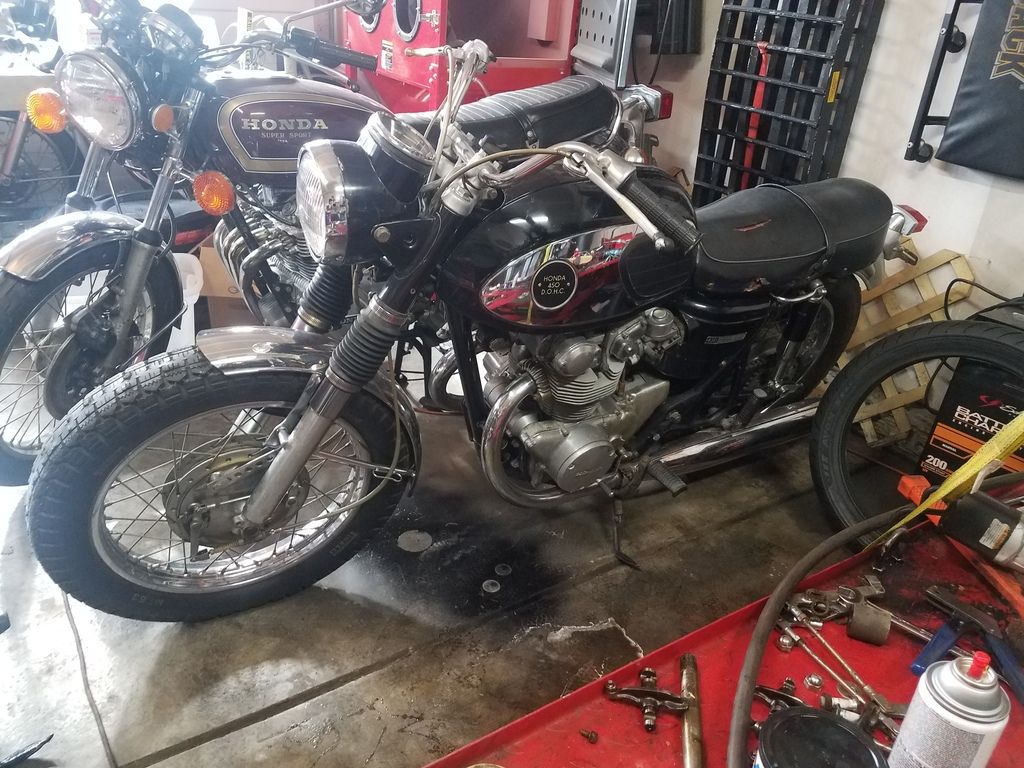

I got a good bit of work done between last night and today. The gas tank had some surface rust in it and a PO had lined just the bottom of it with Kreem, over the rust, of course. So I started with aircraft stripper to remove the Kreem. That came out very easily. Then I rinsed it out with water a few times before filling it to the top with white vinegar for a couple days. I dumped that out, rinsed it with water a few times, then denatured alcohol, then acetone, and finally lined it Caswell. I'm very pleased with the results. Now I can send it down to Pete from Pete's Ponies for paint. He already has the rest of the parts.
Here's a before and after
While that was going on, I was working on installing a few more parts and started restoring the horn. That's all done except putting it back together. I'm waiting on a new rubber seal that goes around the wires.  There isn't one made for the CB77 but there is a company that makes one for the black bomber and it looks similar enough, so I ordered one and I'll make that work.
As the work day was winding down, I got a special delivery from Nashville, TN...
Not 1, but 2 more black bombers! So this project will take a backseat for the next week or so while these 2 become 1 and get all of the parts up for sale.

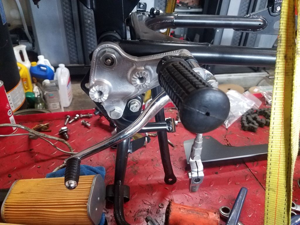

I got the rear brake put together and the wheel temporily installed as well as a couple other little things. Not much else I can do until I start getting parts back. I will do a couple other small things like rebuild the petcock, put the carbs back together, and maybe some other little things.

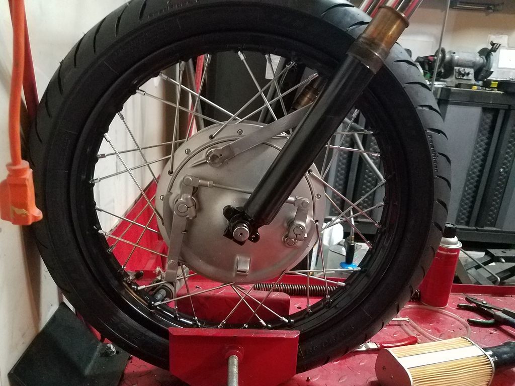

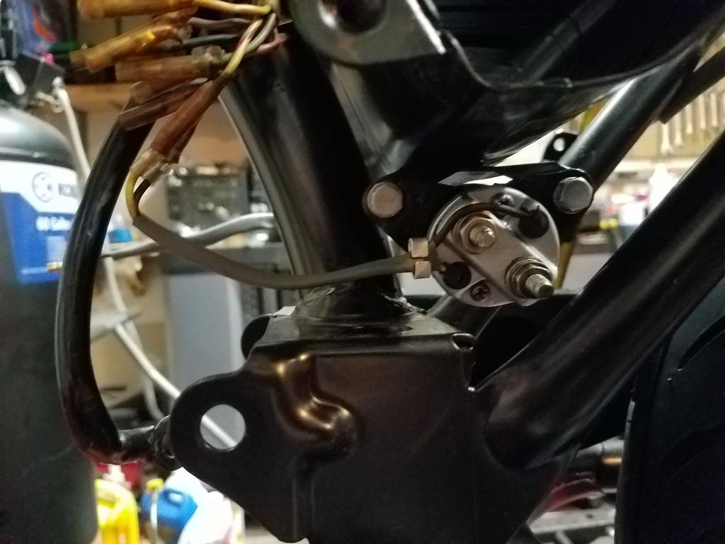

I tried to make a little more progress with what I have. Got the front brake together and mocked up the front end and rebuilt and painted the starter solenoid. The brake linkage couldn't be rechromed because it doesn't come apart so they wouldn't do them. I tried out the "chrome plating" paint. I think it came out OK. Doesn't really look chrome, more like a satiny silver. Pete has finished up painting my fenders and sent them back, but I haven't gotten them in yet. I leave tomorrow for California for a week, so there won't be any work for the next little bit. I should have a lot of parts back when I get back, though, so, hopefully I cant really make some significant dents when I return.
