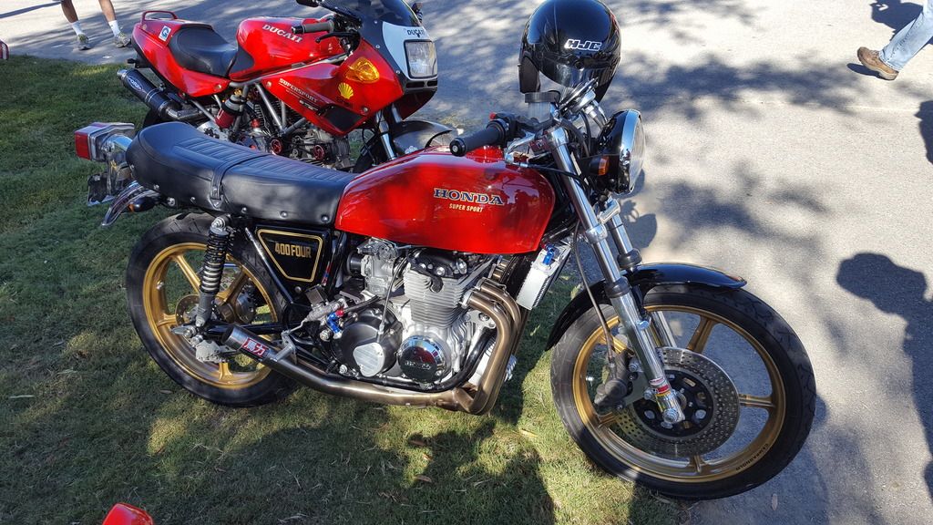

Offline slikwilli420
  • Master of Disaster
  • Posts: 2,357
Re: CB400 guys that went the cafe route
« Reply #7 on: May 24, 2017, 12:36:30 PM »
That engine cover has been... butchered is the word that comes to mind.
Ouch bro. I actually dig it. I even thing some brass/bronze screen behind the holes would make it pop against the gold in the paint.
Either way, there are a number of takes you can do on the "cafe" theme. Basically look at and 4 cylinder bike you like and make your 400 like that. I am personally a huge fan of Rickman bikes, and a 400 in Rickman body work with a silver frame would make people look twice.
I saw this one at Barber last year, and I think it is by far the best treatment to a 400 I have seen in quite a while.
I spent 20 minutes pouring over all the details and there was almost nothing I would change.
