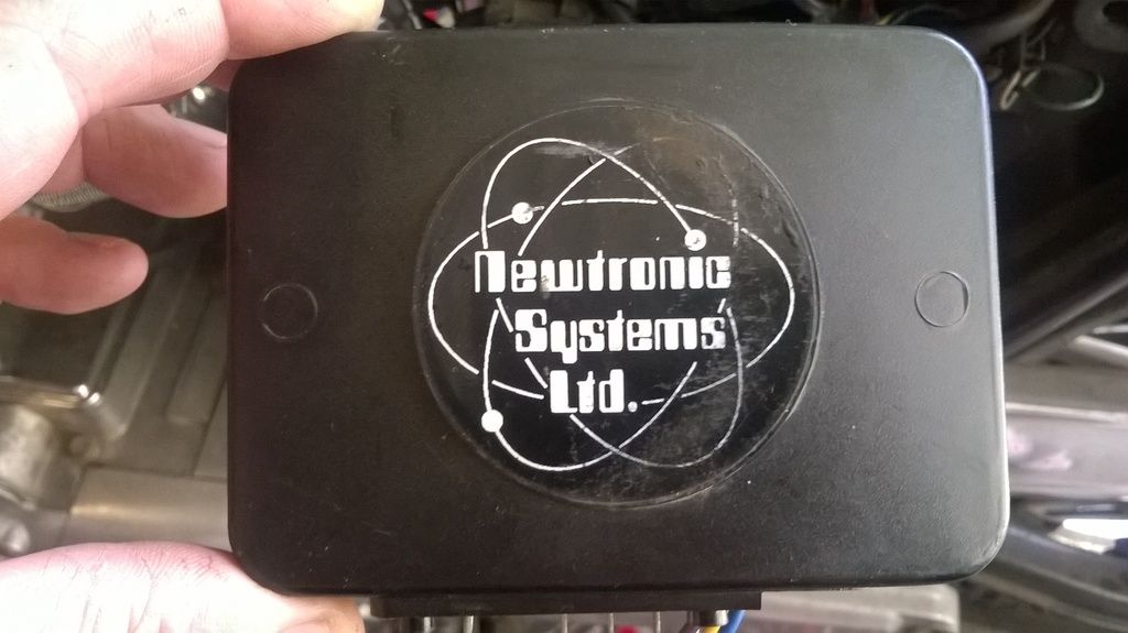

But whilst the side cover was off and I was pressing the starter button, I tapped the Newtronic switching unit with my finger a few times and the bike fired up and then cut out.
Aha!
So I removed the Newtronic switching unit, took it apart and look what I found...
Front of the Newtronic switching unit:
Rear of the switching unit:
After removing the outer rear cover, and revealing the inner plastic cover with some tell-tale brown marks in the bottom left corner:
After removing the inner plastic cover and revealing the circuit board and frazzled components in the bottom left corner:
Close-up of the frazzled components:
I'm going to get in touch with Newtronic and see if they can supply a new board or the just the components that need replacing, unless there's an electonic wizard on here who knows better and can help.

It looks like maybe overvoltage? The two burned things are a diode (easily replaced as these are standard parts) and a zener diode - you need to get the part number from it to replace it, since zener diodes have a specific voltage specification.
The three terminal device could be a few things, so hopefully you can get a part number from it? Likely a transistor or voltage regulator.
The two large resistors that look burnt - not a worry, you use 5W resistors because they will dissipate power. The discoloration just says they did so, it's not abnormal. But having some components heating up that much suggests a dubious design...
I would toss it out, put the points plate back in, and invest in Hondaman's ignition module. That uses the existing points for timing, works very well, and if it ever fails you can easily switch back to basic points ignition.
