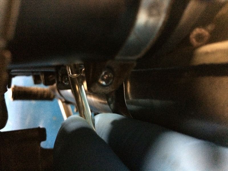

Thanks for the input so far.  They looked pretty good, maybe even a little low?
The tank was in the way so I didn't check 3 and 4 yet but neither are leaking.
I started it up last night with the petcock off and it started right up no choke and idled nicely.
FWIW the overflows are now just dripping with the petcock open - last night it seemed like it was more or less pouring.
