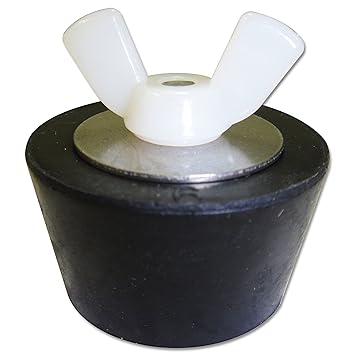

you can pressure test it yourself pretty easy go to a pool store and get a big expandable pool plug that fits the filler hole. then you can pressure it through the petcock, just keep the pressure very low like 5psi or under, any more and you risk deforming the tank!!!
