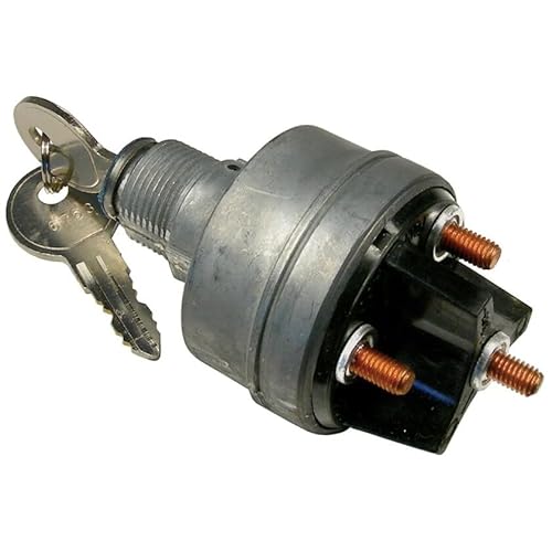

You can get around the starter button all together by getting a universal car-type ignition switch.  I bought one for $6.00 at the local Auto Zone.  You just crank the switch to start it.
I mounted it to a piece of sheet metal near the right side cover.  The white star shaped thing is my key ring.  It cleans up the dash quite a bit, but you need a third hand if you want to hold the clutch, hit the starter and give it gas at the same time.  I just start it in neutral.
