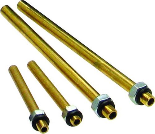

you got a carb vacuum sync screw?  those work.
No drilling needed with a PVC fuel line connector either.

Carb Vacuum sync screw????????????
Re: Clear tube float check
« Reply #13 on: July 17, 2018, 08:24:47 AM »
I used an old drain screw. I drilled it from inside to outside and soldered the little copper tube into it.
Alrighty man, thanks for the tip.
Yeah....this thing

I never checked to see if they were the same thread, the short one should work fine.
